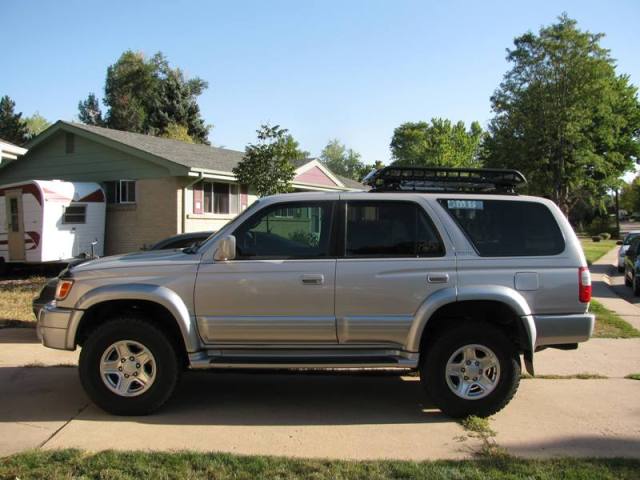

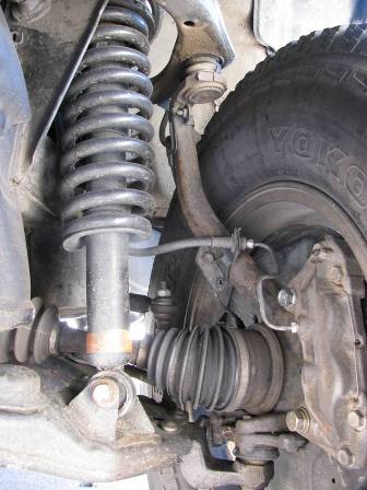

Ok, so after a ton of searching I decided to install the OME 3" lift with 881s in front and 890s in the rear. I also did the top plates in the front assuming that it would level it out. HOWEVER, I still def. have a noticeable rake in the front. I don't have pics yet but I will post later.
Oh, I also did do the diff. drop, so no worries there as far as wear and tear on the CV axles.
I do have stock shocks all the way around but is that really the only cause for the rake? The shocks are all in great condition so any help would be great!!! No additional weight in the front either...

You may have the top plate installed wrong. Need pics
Old Sep 29, 2010 | 03:36 PM
mswenso1's Avatar
Joined: Dec 2008
Posts: 30
From: Centennial, Colorado
Here are some pics...

See, I thought it would settle too but these pics were taken 1 month after install AND after a 2400 mile trip from Colorado to Washington State and back with over 500 lbs in the rear the whole time!!! To be honest, it was probably closer to 750 lbs...

Do you have the stock cones installed in the rear coils or no? They should be left in and that's a .5" difference right there.

I guess I'm not reading it all correctly. Rake to me means the back end is sitting higher than the front. But your original post reads "...still def. have noticeable rake in the front"
Yet later you refer to it as the rear higher than the front-post #15. I'm not seeing rake in the picture. Is that a level driveway? You sure? Have you compared on other flat surfaces?
Many of us are running the 890s, so presuming you have the stinkbug look-with the back end a bit higher than the front. You don't like that so let's figure it out.
We've seen pics of the front end, so now lets see the rears. It's my guess that the rear springs are not positioned correctly in the indent.You know how the coil matches up to that groove on the bottom side? Is it slid all the way over with no gap?
We'll get it figured out. Let's see the upside down cones and the bump stops. The more pics the better. Let's hear some measurements too. Ground to bottom of the flare, both sides front and rear. And center of the hub to bottom of the flare both sides front and rear.
Any chance the Old Man Emu springs are not truly 890s? Were they in original packaging? Even so I am taking a wild guess that they are 891s in 890 packaging. Any tags on them when installed?
How is it riding? It looks great. Feel free to stay in touch with me and we'll chase it down. Bring it by if you like and we'll figure it out.
