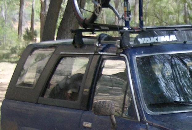

Y'all don't have to drill or use the fiberglass drip rail with the old Yak system. I have YAK SST towers with Y-10 clips and the extender bars. Two clips go on the steel drip rail and the pads from the towers hold the weight at the top of the curve of the roof. I could haul 200lbs on it with out it being a problem with the rack. CG would be painful on corners... It's bomber. 10 minutes on, 5 minutes off. No drilling! Skis, bikes, lumber...
The SST & Y-clips (& stretch) have been replaced by the Q-towers, Q-clips, and Q-stretch. You'd have to look up what the Y-10 clip has been replaced by in the Q clips.

Old Dec 18, 2006 | 12:12 PM
86Original's Avatar
Joined: Feb 2006
Posts: 458
From: Loveland, Colorado
The stretch kit allows you to get almost that far. See the attached picture for an example of what you can do. Not sure if the Q-stretch is the same length as the SST stretch kit or not.
Ditto on the paid for (18 years ago ), but still don't like to drill. Besides the load capacity on the Q-towers (& SST) is much greater than gutter mounts (1A towers).
