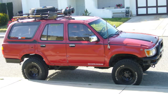

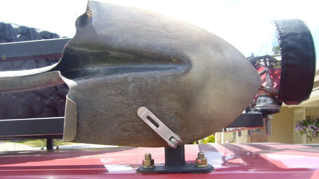

this is what i did.
i put reinforcement plates on the inside and siliconed it and have no leaks. looking back i should have run the roof mounts all together down each side for better weight distribution on top.

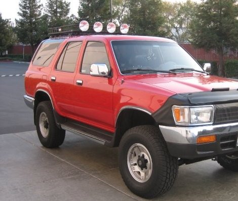

I bought a Thule basket off Craigslist for about $80 and the clamps that came with it fit my luggage rack perfectly. Have you thought about just going to the junkyard and picking up a luggage rack?
Also I Yakima makes crossbars that fit in the rain gutters of your 2nd gen...
Attached Thumbnails Roof Basket Direct Mount?-basket1.jpg   Roof Basket Direct Mount?-basket3.jpg

i have six mounting points (three per side). what i meant was that i should have run flat stock from the rear mount to the front similar to the way the factory mounts/slider things do, however i have not had any problems yet and its been LOADED a time or two. just remember to silicone the mounts liberaly for leak prevention, then trim off the excess. if you need any more detailed pics or help with ideas concocting let me know. by the way you know you can always incorporate your lights into the rack as i did and sell your light bar to cheapen the project. $.02

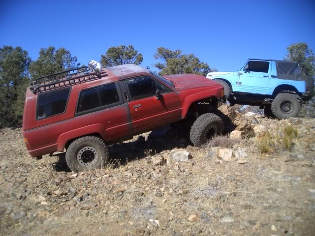

Heres mine bolted through the roof

Yup. I ran 1 inch metal strap across the inside so the bolts wouldnt pull through. I drive through alot of low hanging trees

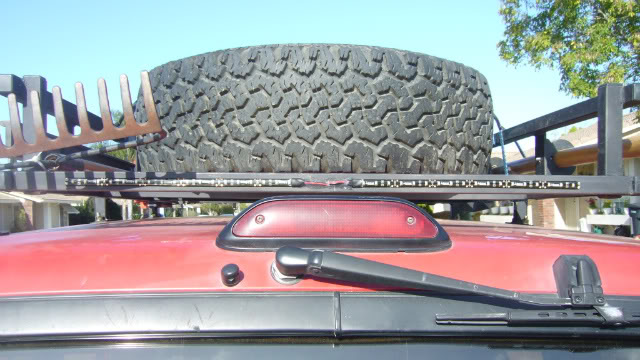

i dont have pics of the inside mounting, but make sure you plan out before you drill due to roof supports, sun roofs, and whatnot. one more pic for now.
