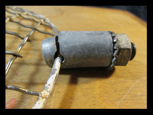

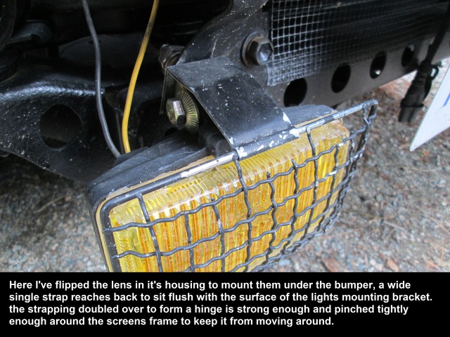

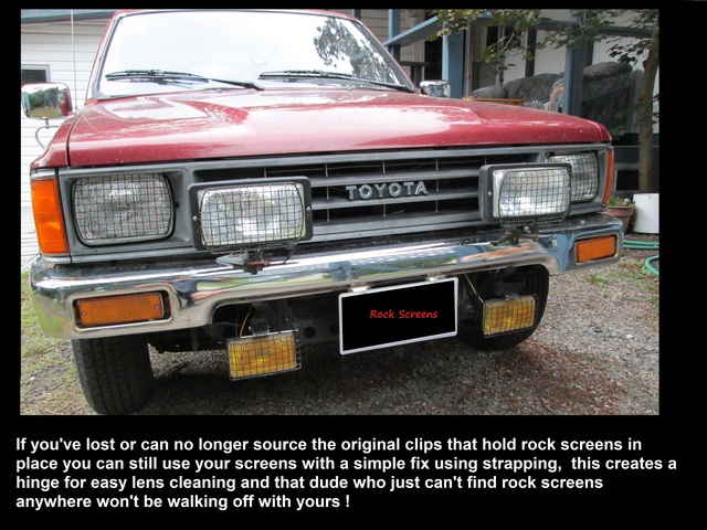

Rock Screens

Another great write-up!
I'd add only that using the correct metal may prevent this excellent mod from looking crusty in a year. Aluminum, stainless, or something powder coated? Think it through with whatever you go with!
Old Sep 3, 2016 | 09:41 PM
pursang's Avatar
Joined: May 2007
Posts: 75
Likes: 11
Thanks tj, your right even the galvanized strapping tends to rust over time as do some of the stainless screens, mine usually get a rattle can spray at least once a year.
