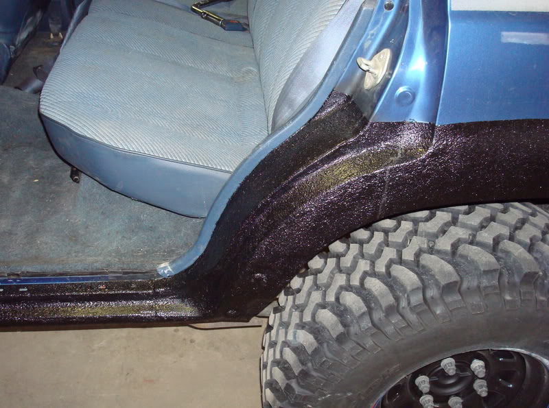

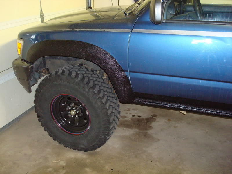

OK, so I started this thread a while back, and since then I have finished my Herculiner project. Someone PMed me asking how it turned out so I thought I would post some pics on here and what I learned:
The biggest thing I learned was 1) to not let it rain on fresh Herculiner (I painted it on and left it outside and an hour later it rained and it bubbled up a little bit. You can't tell now but if I wouldn't have caught it early enough it would have ruined it), and 2) Don't wait too long to put the UV protectant on. I put mine on a month later and that wasn't too big a deal, but I didn't re-tape so I didn't get the UV protectant all the way to the edge, so now there is an 1/8" gap where there isn't herculiner and you can see that now. Just make sure you cover it good with the UV protectant. It will start to look like crap without it. I need to go out and retape the whole thing and get the UV protectant everywhere I missed the first time I tried. Also, I've learned that its tough to get mud out of the Herculined areas after you've gone wheeling. It takes a little more work than just a normal car wash.
