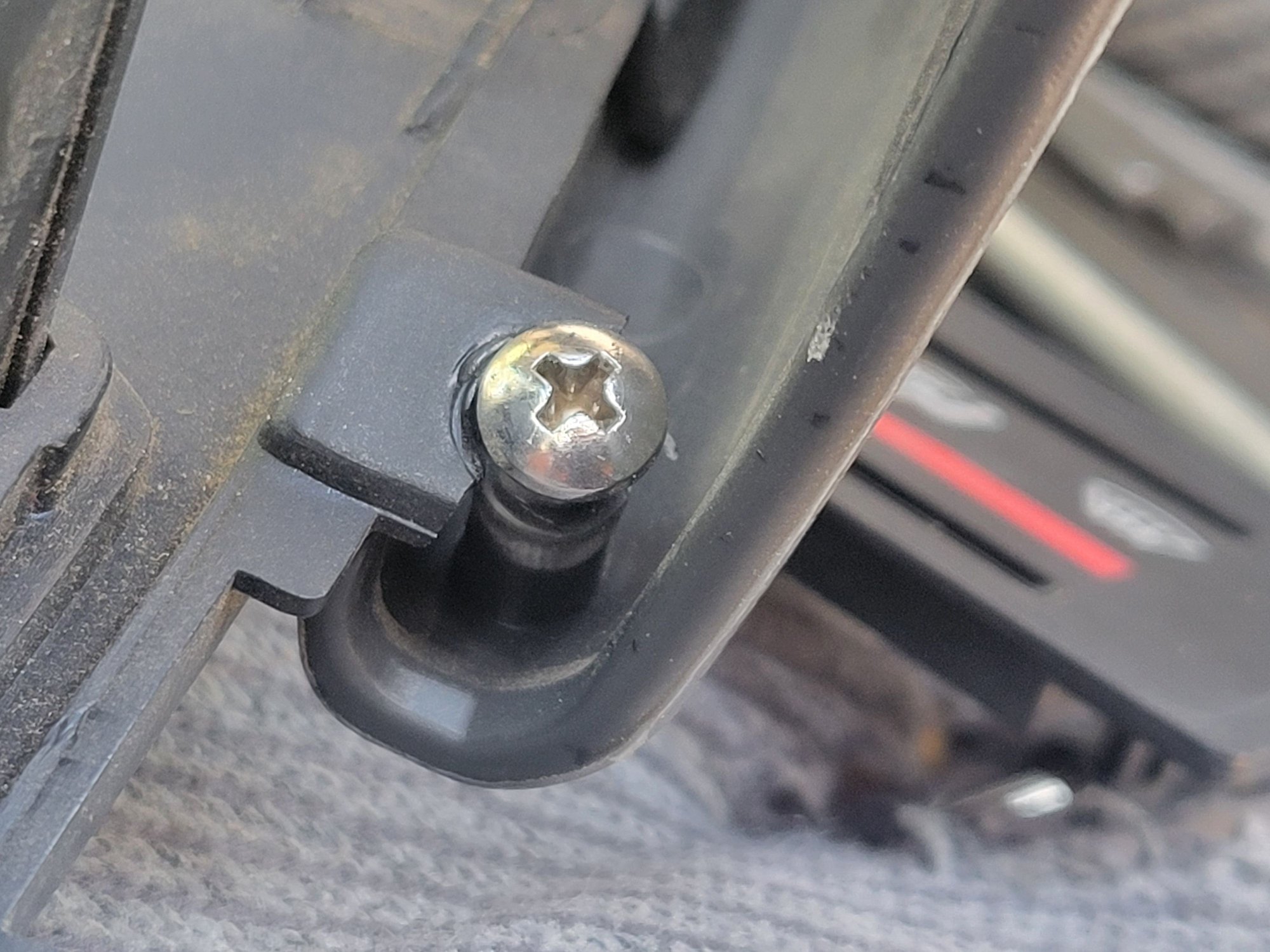

My 93 DLX dash bezel is cracked and needs replacing. These appear to be harder to find and more expensive than SR5 and 4Runner replacements, and the SR5 bezels have an extra switch opening for more accessories. Will an SR5 dash bezel fit in my DLX pickup? They look the same dimensionally (though I don't physically have one to measure). My biggest concern is that the SR5 bezels don't appear to have screw holes to mount the upper DLX dash trim.
My current bezel part is 55404-04010, and the SR5 replacements I have seen are 55411-89109. I don't care too much about looks, but I would like a functioning bezel that doesn't rattle.
