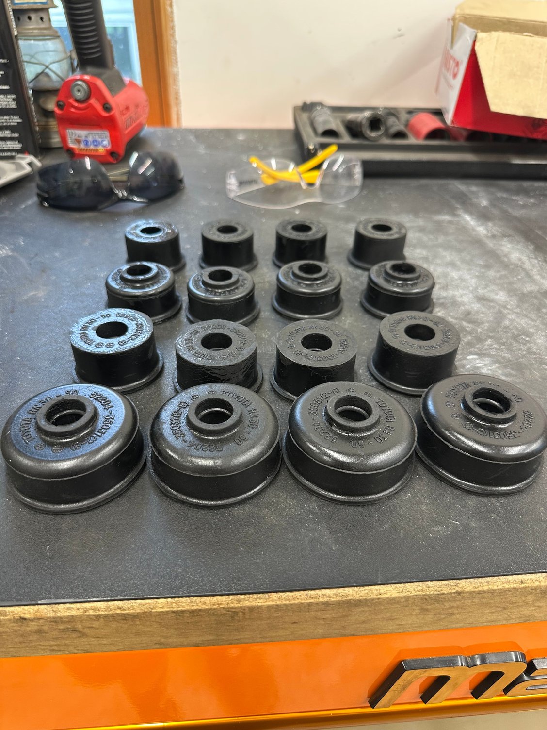

Having a really rough time finding any diy write ups or how-to videos just to verify how these all go together. I understand the process but I’m trying to atleast see if I have the correct set and can’t find any good exploded diagrams either.
this was a 58$ eBay special because I really do not want to go the polyurethane route with my 94xtended cab.

Looks like the "rounded" cushions go on top of the frame piece, and the more "squared off" cushions go under the frame piece.
https://parts.lakelandtoyota.com/sho...roduct=3997786
That diagram is for '79 thru '83 models, but I suspect other year groups would be the same. '84 thru '88 look very similar.

Well, I'm more used to the older models, and you also didn't specify in your original post what year you were working with. I don't think those bushings are going to work on your '94. Pretty clearly marked on the bushings it says "RN30-50". Those models are 1979 thru 1988, which is why I said what I did.
Your '94 is a RN101, which falls in the 1989 thru 1997 years.
The #2 & #3 cab bushings are different than what you have there:
https://www.toyotapartsdeal.com/part..._mounting.html
Those seem to have metal plates are part of the bushing(s).

I also found this diagram, correct for a '94: https://toyota-europe.epc-data.com/4...264/body/5251/
