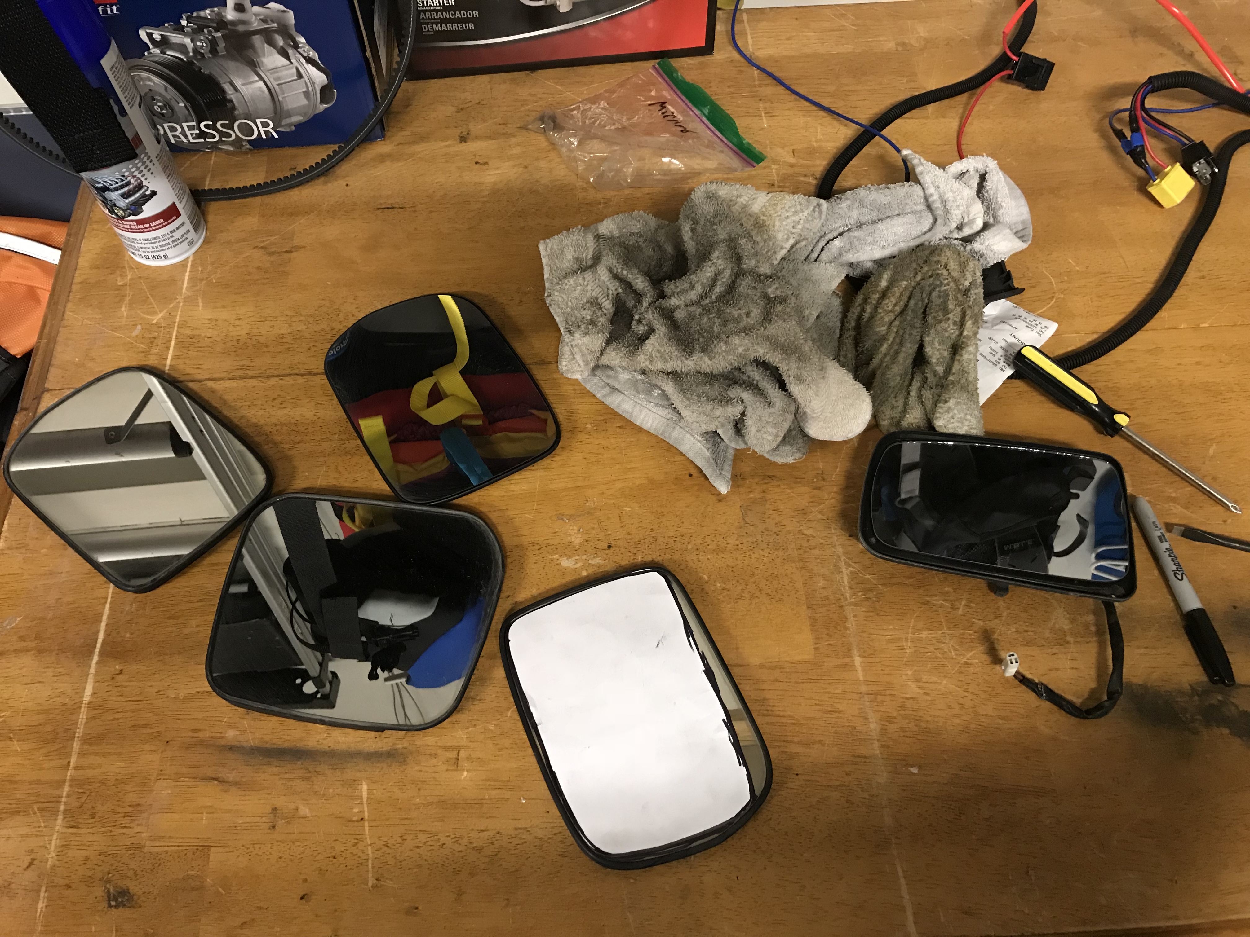

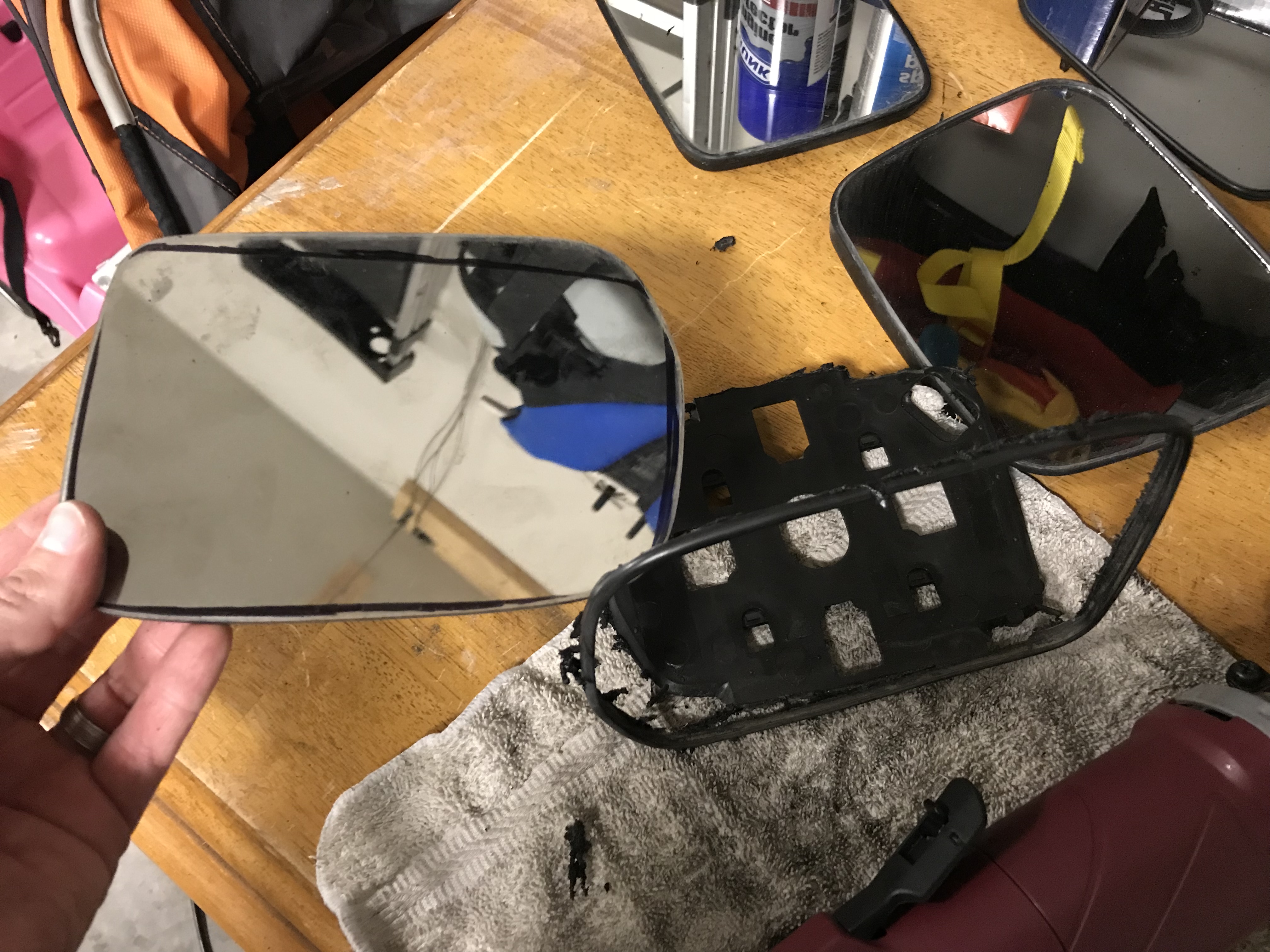

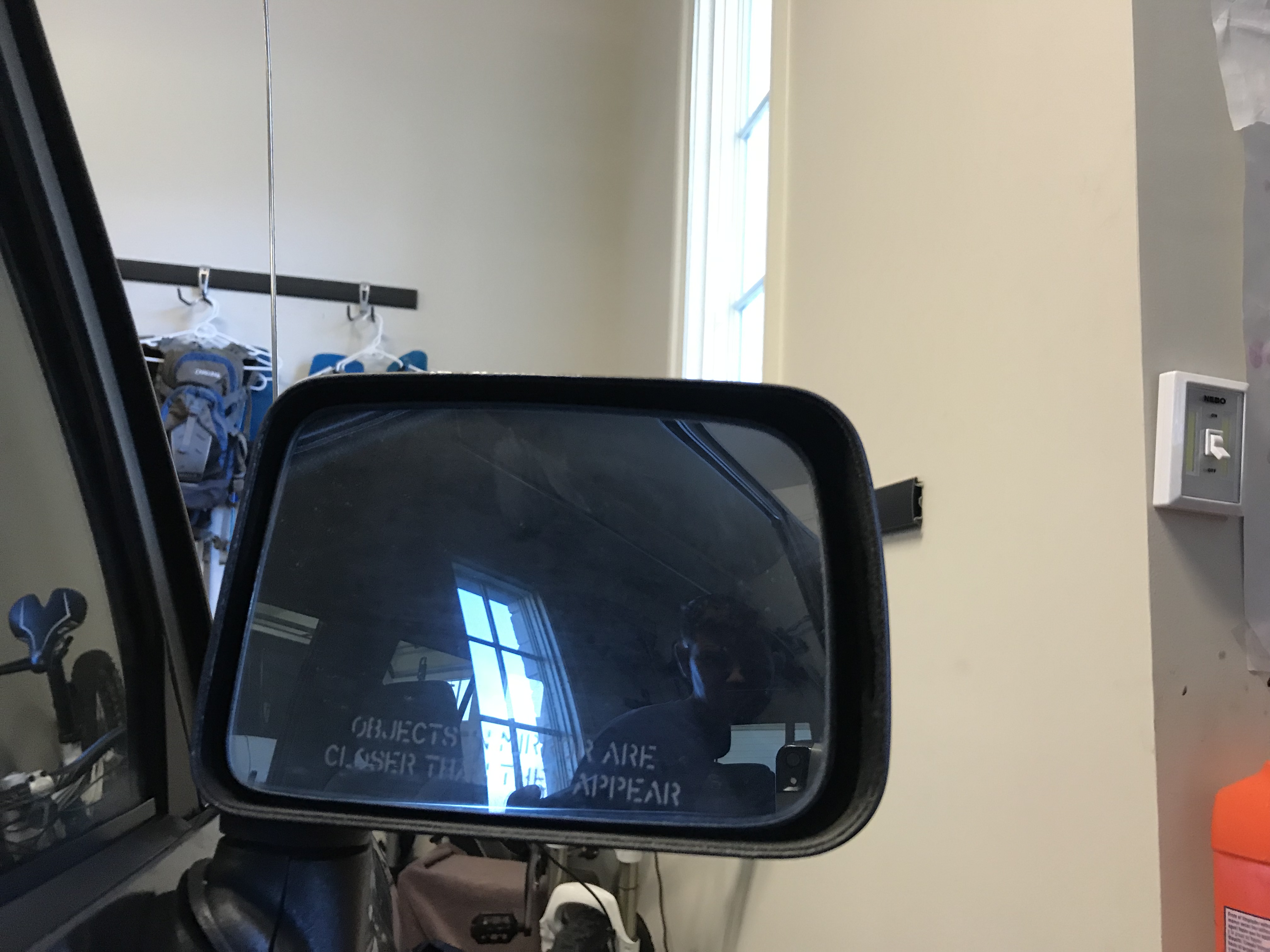

Update: I never found a replacement mirror so I went a different route. I made a paper template, took it to the local salvage yard, picked up 4 slightly larger Drivers side mirrors for $4 each, and grabbed a mirror cutter at Home Depot ($2.50).
I then:

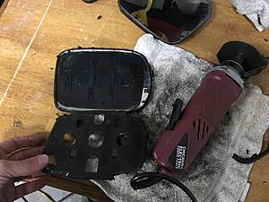

1) Cut the plastic backing off with a cutoff wheel (do not try to pry the mirror off as it will crack - instead cut the plastic off the mirror)

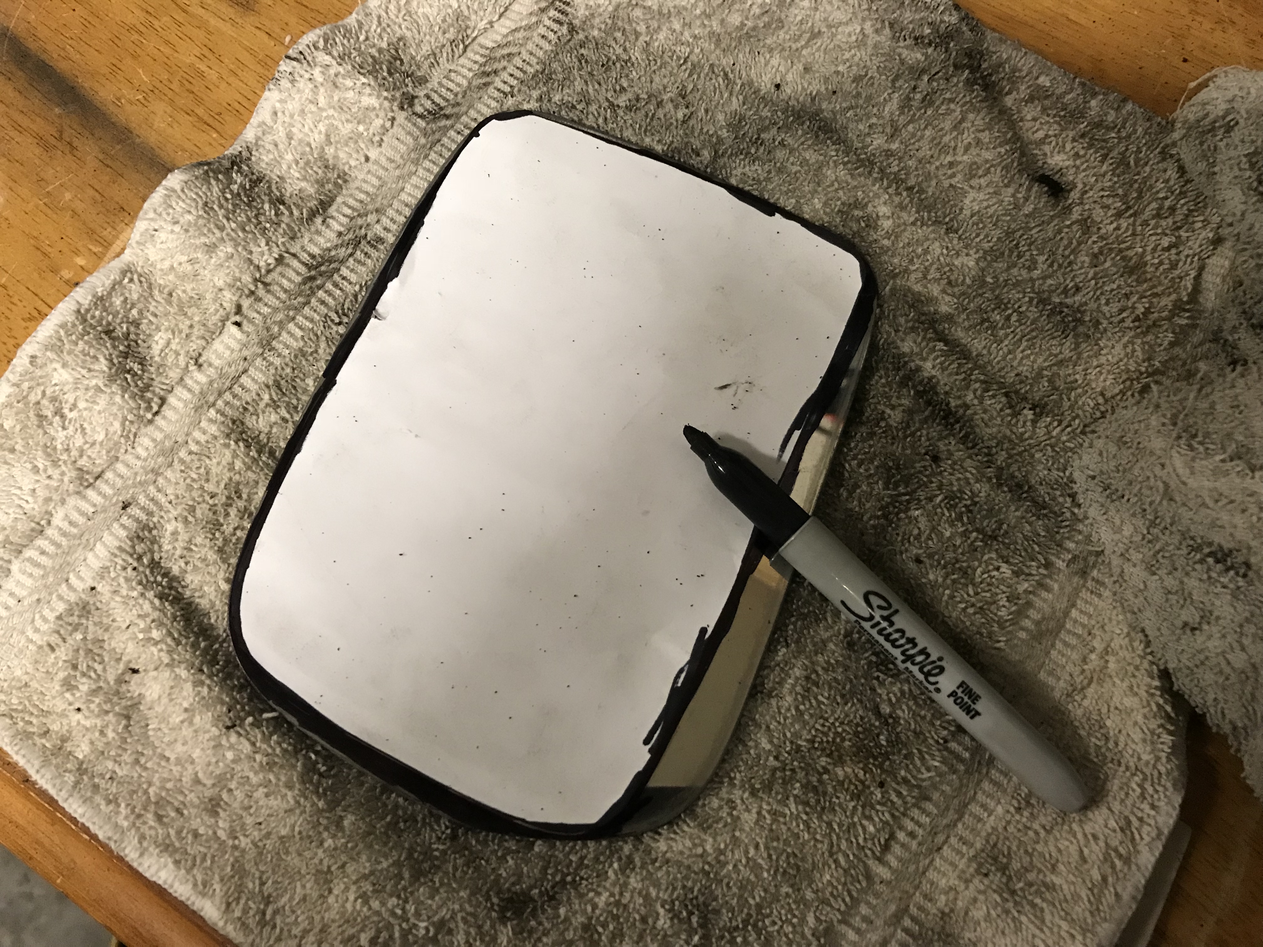

2) Traced the paper template onto the mirror With a sharpie

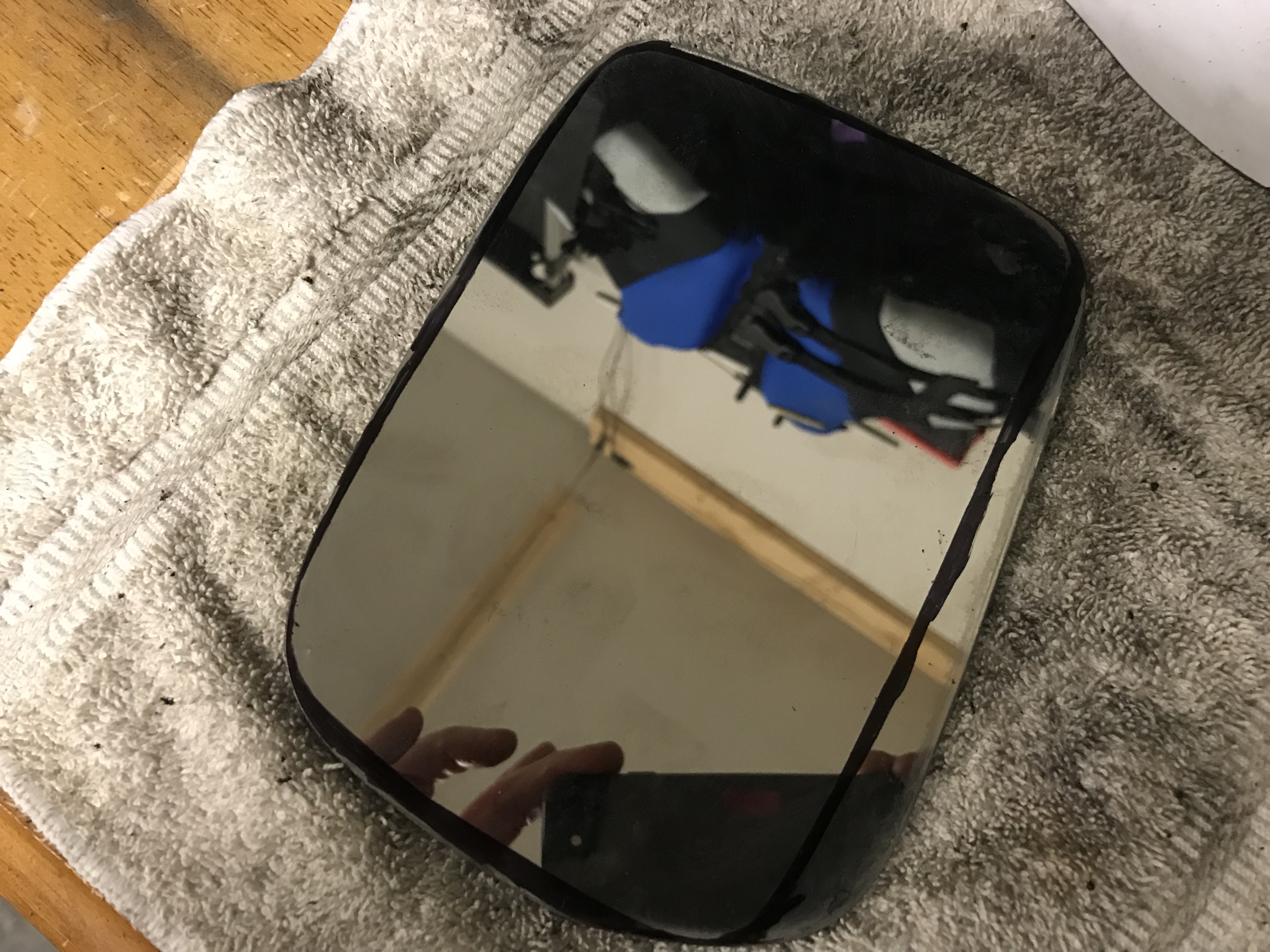

3) Cut and then snapped off the excess one small piece at a time, taking my time
4) Then filed/sanded the edges smooth
5) Adhered the new mirror into the OEM power mirror bracket.
I bought 4 assuming I would break a couple while I figured it out, but the first one went seamless so i’ll save the others for the future considering there really aren’t any OEM replacement options left.
Pics below. For $6.50, it is a great option for those liking to replace a Power SR5 mirror insert.

More Pics:

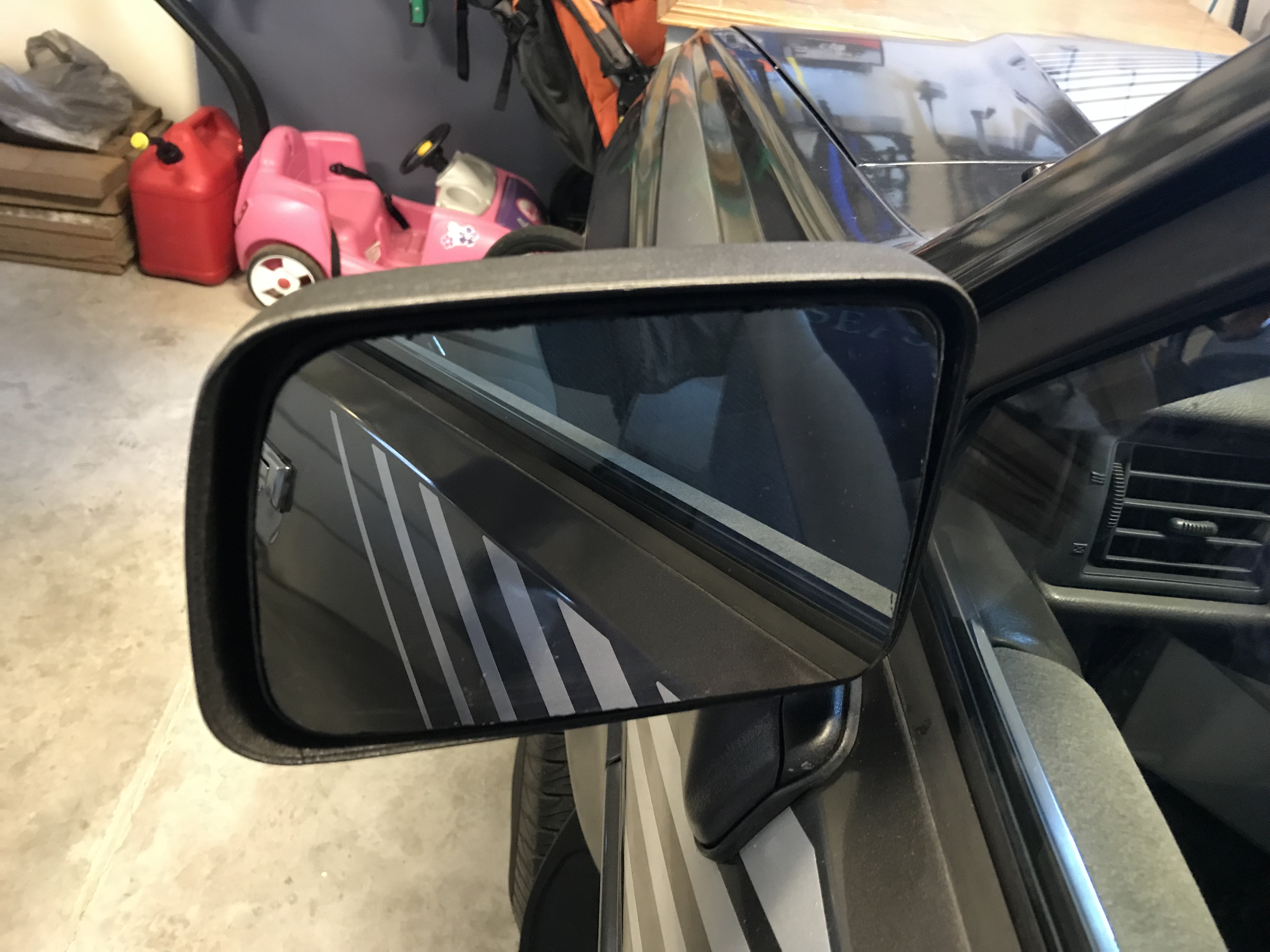

Installed. Yesterday a Honda Minivan mirror. Today a ‘87 SR5 Mirror!
Attached Thumbnails Replacement Mirror Insert Glass for SR5 Power Mirror-d8f14030-0fa4-4ec7-bb3a-ee458b09c937.jpeg   Replacement Mirror Insert Glass for SR5 Power Mirror-ae698c21-81db-480f-8fc2-d96e1c5e6233.jpeg   Replacement Mirror Insert Glass for SR5 Power Mirror-aeb4ace2-413e-4ec8-b009-b007b26244c4.jpeg

Originally Posted by maco35
Thanks for the update, i'm gonna try to do this but with the passengers side mirror, i'll post my results with that project.
For Passenger, you’ll have to find one where the bottom edge matches well since it has the engraved wording. Then cut the other 3 sides to fit.
Good luck!
