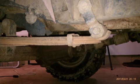

does it look like i need newleaf springs?
i just got this truck and i didn't think it had a lift on it, but after reading this site over the past few days, i think it has lift shackles and perhaps lift springs. Any input?

Those look like the stock shackles to me. The springs look totally flat, I've seen worse though, some go to a negative arch just sitting there with the weight of the bed.

Holy Sag, Batman.

....thats a front axle guys. and tose are flat but ive seen fornt springs that could pass for upside down rears. the stock front springs dont have much of an arc to them to begin with. yours arent the greatest but its not someting i would put on the top of my list unless there wasnt really anything else to be done

Oh yep good catch. The front has the engine weight and would sag more.
