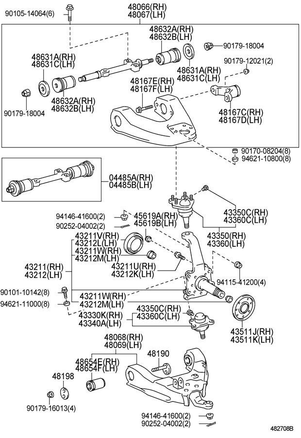

Diagram
Part number 43511J Or 43511K is also 90313-93002
Happy wheeling
