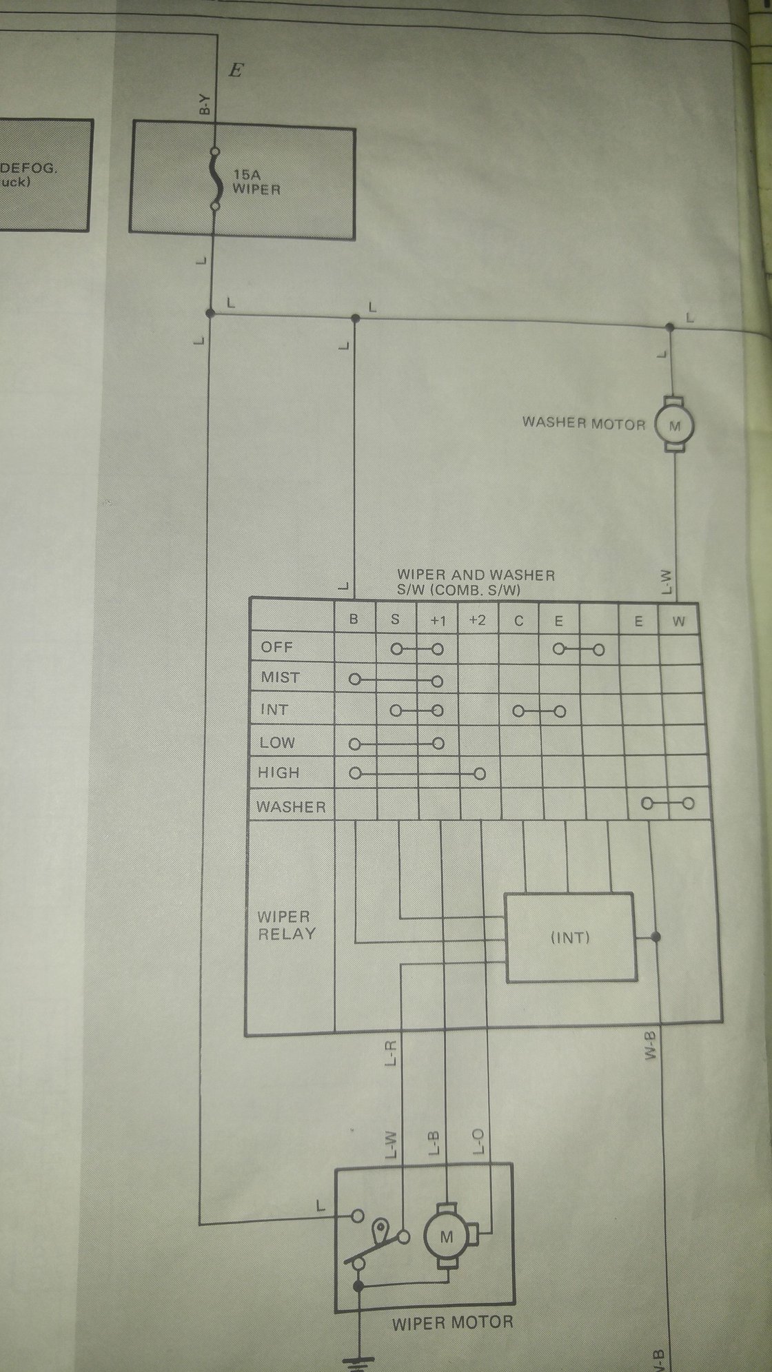

Old Feb 24, 2020 | 12:07 PM
Paul22RE's Avatar
5 Year Member
Joined: Feb 2018
Posts: 605
Likes: 159
From: NNJ
Here is the color code for an 87, (L is light blue)
