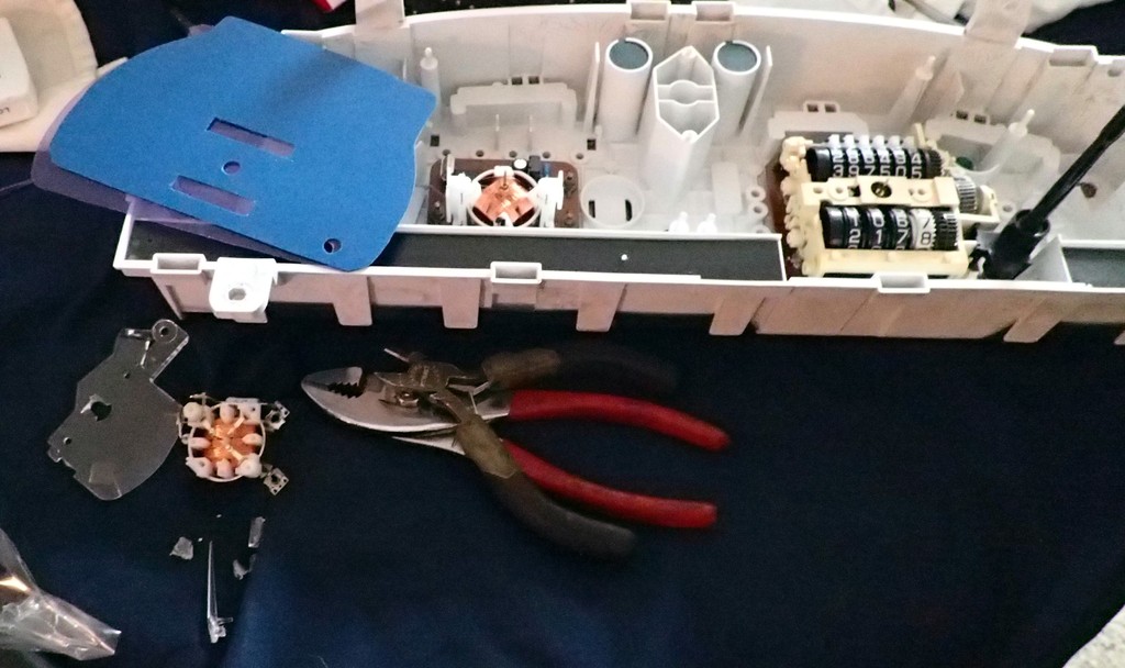

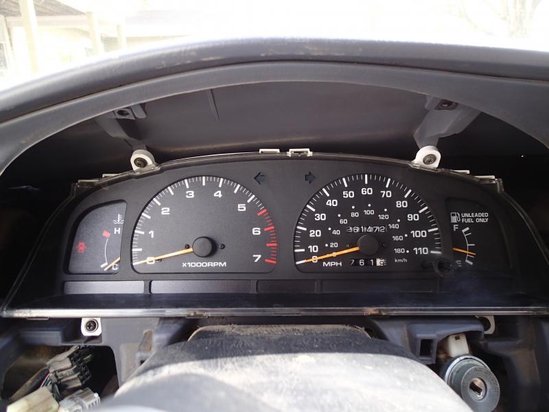

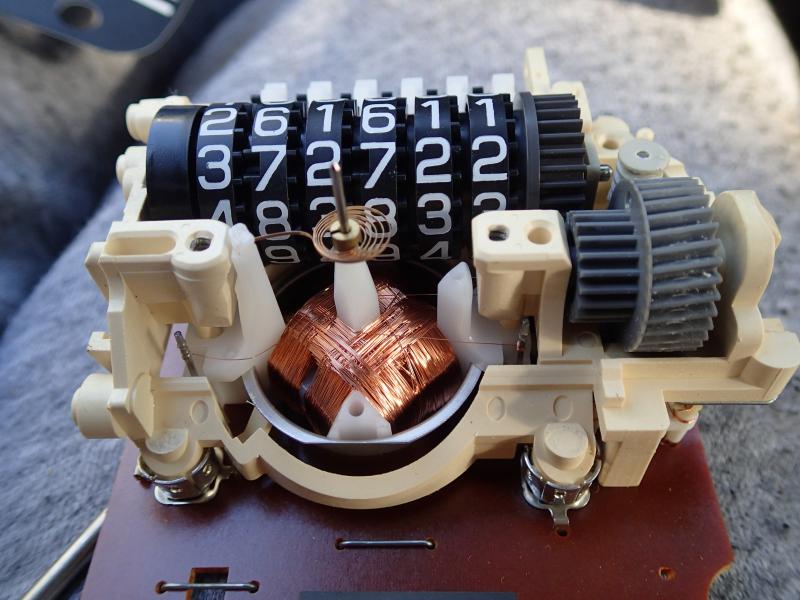

I'm not much help but here's some pics for what it's worth...
My 96 4Runner's speedo is electric, not cable...usually abs-driven, I'm using a sender out of a 96 base tacoma with no abs, still electric.
Pic of cluster with trim removed....

speedo

The electronic signal is the same, one pulse every 10cm traveled.
There were two mechanical speedometers with differing input size, the larger ones have an insert to mate with the cable which is the same diameter
