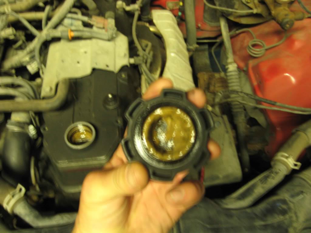

yes very possible but you will need to clean/flush the motor with a couple oil changes. here's how i know. Name:  IMG_0832-01.jpg
the guy that traded me the truck assumed the head gasket was gone. not the case. The timing chain needed to be serviced for some time then wore through the cover. This led to the coolant being pushed into the oil. Not saying this is your case here but would be something to look into before shelling out almost a grand for a motor when the one you have could be fixed cheaper. This is on my daily driver and the little truck runs like a top now.

OK, got the valve cover off. Chain seems really loose on the driver's side, but damper is still there. There are some marks in the cover I can see from the chain, but it looks like that was from a previous time, as the damper is over them now. Is there somewhere else water could be leaking into the oil besides TC Cover, or head gasket? I'd think the compression numbers would say the HG is good, but I guess there is still always a chance. Here are some pics. I guess next course of action is to pull TC cover and oil pan, and do some more inspecting.

oil looks like it's from the valve cover. Compression numbers don't look too bad. Check the timing chain guides. I still think that is your problem.
