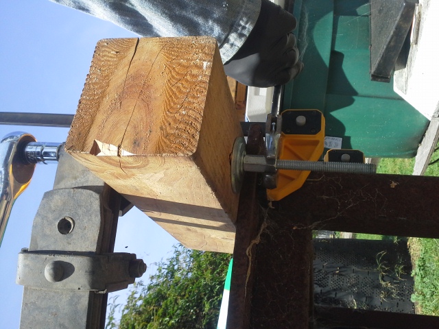

this is my first post so hopefully pics will work! hope its not bad etiquette to revive an old post, this would have helped if i thought of it sooner.
Here's my solution. Less messy, and if your bushings are reusable this will save money. It's just like a simple bearing press. get washers and nuts the same size as sleeve that goes inside the bushings and drill out the wood block to large enough hole that only the sleeve fits. it simply presses the inner sleeve out then you should be able to slide out bushings, they take a bit of wiggling.

Not a bad idea per se. But, based on previous experience, I don't see it working in all cases. The one time I tried replacing one I had to use a cold chisel to open up the eye a little bit before the bushing could be pressed out. I guarantee I would have snapped that bolt if I'd have used your tool without doing that first.
EDIT: Shoot! I didn't realize until looking closer. We aren't even talking about the same kind of bushings. You have no clue. Some of them have an outer sleeve. Gives a whole new meaning to the term PITA!

Mine have an outer sleeve, they are old man emu. Perhaps I have no clue, however I didn't need to torch a good set of rubber bushings. My logic was the inner sleeve (that the bolt goes through was forcing the bushings to fit tight and removing it would remove pressure, and it worked, all but 2 of 8 slid out of the outer sleeve with almost no effort.
