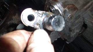

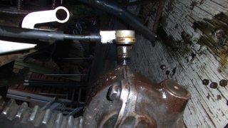

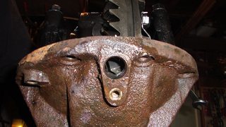

I have been having problems with the rear end in my 1993 4runner, while driving I could hear a rumble sound from the back, When I stopped I felt the rear axles and they were cool but the pinion was a different story, the front of the snout was hot, hot enough that you didn't want to leave your hand on it for long. I pulled the ring and pinion and can't feel any rough bearings and all the teeth on both are in good shape. When driving and I stopped, then started again sometime I would hear a pop like something was going through the gears. There was not any metal on the magnets and nothing in the case. Any ideas as to where the popping and growling could be coming from. I have it apart so am going to replace the bearings in the pinion and ring gear. One other thing, on the top of my differential there is a round silver thing attached to the differential and held there with a bolt and a bracket. Photos to follow.

What is it and what does it do, the bottom part just sits above the ring gear but not touching, there is a vacuum line attached to it.

Not a vacuum line, an electrical lead. A sensor for rear wheel ABS.
Differentials generally run 80 to 100 degrees F. over ambient temperature when run at highway speeds for 20 miles or more and the pinion nose is the hotest part.

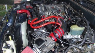

The pinion feels smooth and there is a small amount of force to turn it, not sure of what the torque is as I don't have a socket that fits. Going over to a buddies house in a bit to use his and will see. When I pulled the axles the driver side looked good but the passenger side looked like it may be the problem. You are right, might as well change them also. The headers are from DNA motoring there are a few things that I don't like but for the most part they fit very nice. I am going to change the clamps, the headers are stainless steel and the clamps that come with won't hold they are also slip fit and don't weld great. There is also a small amount to clearance problem with the starter housing. You half to remove the transfer case cooler and turn it upside down to clear the passenger side header.
You can just see one down pipe in this photo
