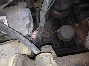

ok here are some pic's
Old Mar 29, 2012 | 03:31 PM
Egar's Avatar
Joined: Mar 2012
Posts: 31
2 green wires, one going to battery and you can see the second green wire going down to the starter. looks like the spliced it in to the started at the plug by the selenoid
pulled the steering colum bezel to check out the wiring for ignition switch. looks like there is alarm wiring and splices....looks like a mess !

It looks exactly as I described. More than likely the alarm had a ignition cut off and the PO just bypassed it. IMO, I would start ripping it all out and put it back to factory. The FSM link in my sig will help out tracing any gremlins you find.
