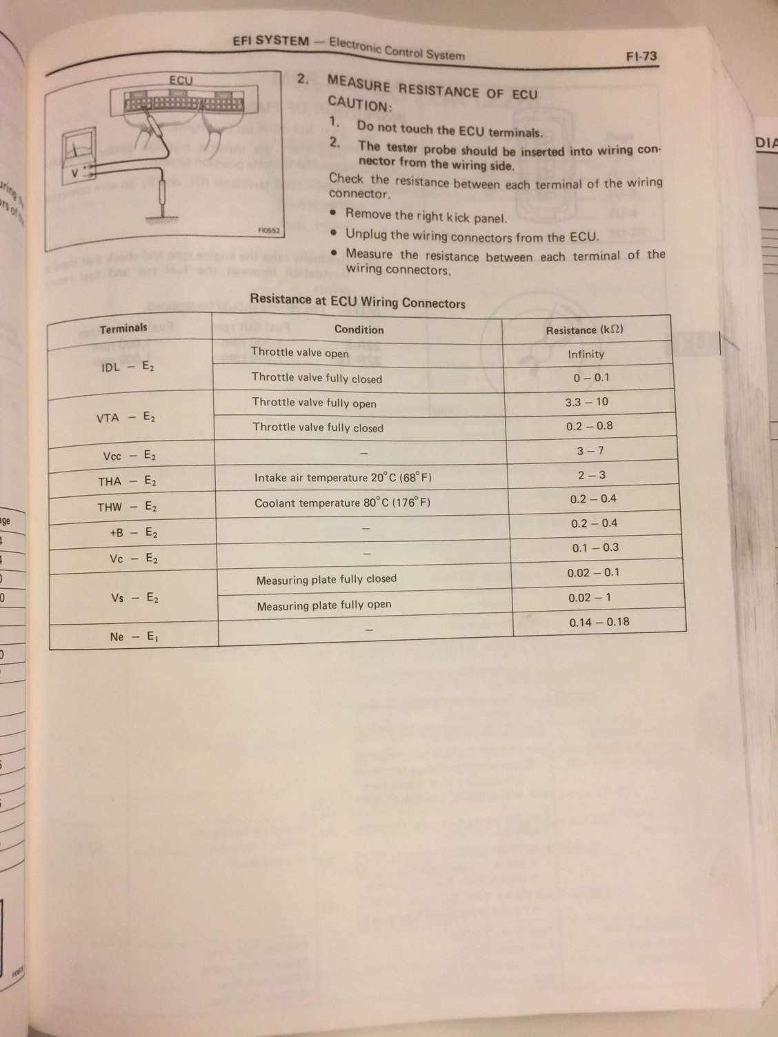

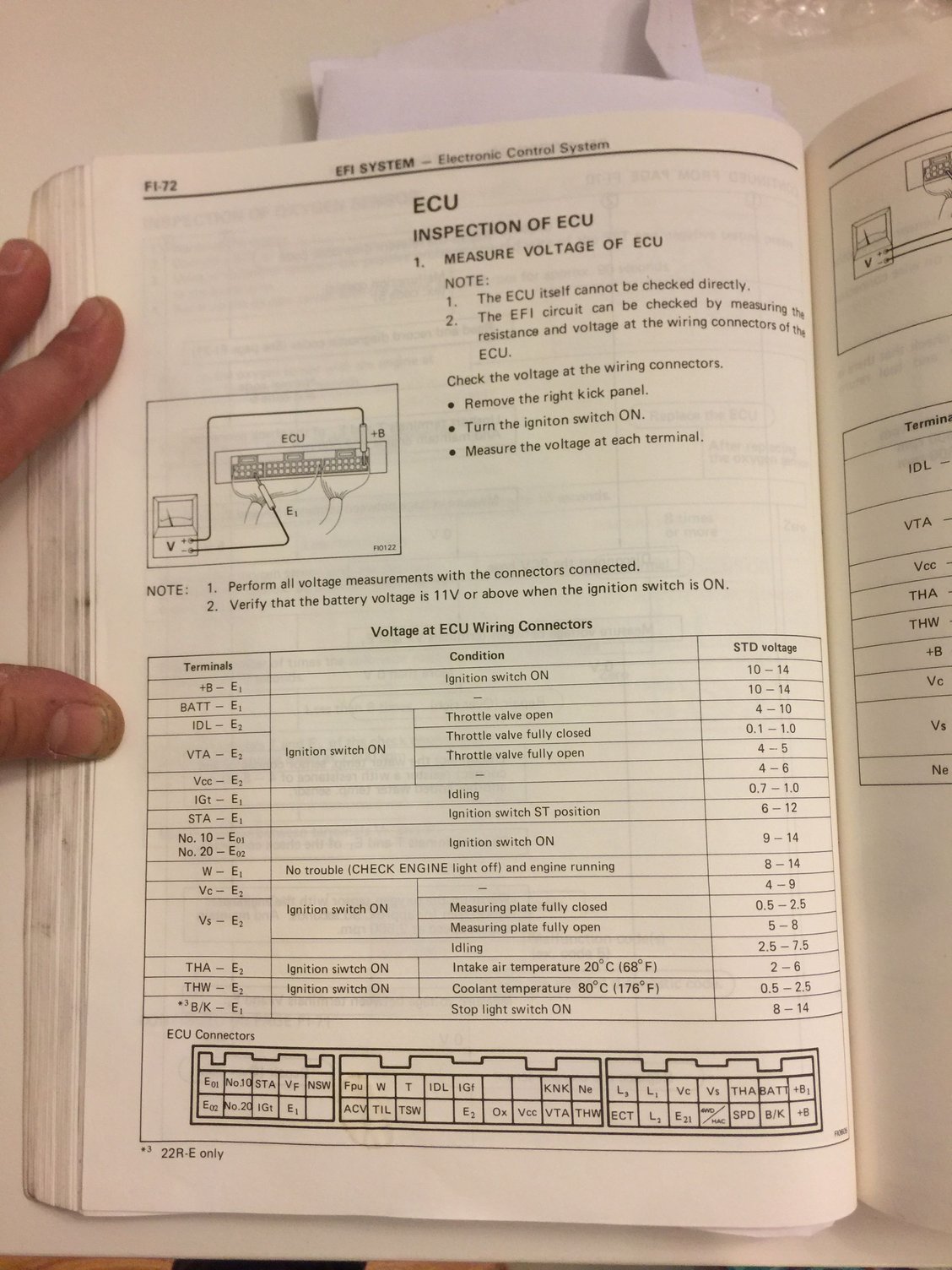

Maybe you should consider being more objective here. Approach the vehicle as if you have no affiliation with it, the owner, or the rebuild. On one hand you admit to not understanding the problem and on the other you make comments such as this.
Originally Posted by 84 yota dude
I can check the signal for the coolant temp sensor at the ECU but I highly doubt that is the problem. The harness was not damaged when pulling the engine.
It’s a 33 year old truck with 33 year old wiring. Did you open the loom and inspect the entire harness? While it may be that the harness was not physically noticeably “damaged” when pulling the engine, copper corrodes and both copper and insulation fatigue, and there was certainly bending and manipulation of the harness. Therefore in order to be thorough, a mechanic would check all signals at the ecu and at each sensor via back probing to insure proper function. Could be as simple as terminals not engaged. There’s a chart in the fsm for both resistance values and voltage values.
I am not sure where the alternate air path could be because the PS/A/c bypass was not touched from the origainal '87 engine.
Again, it is not safe to assume the 33 year part is functioning correctly just because it “was not touched.”
There is a diaphragm and an o-ring inside the ac/ps idle up valve that are notorious for drying up, degrading, and failing. Cap the system off, verify no change.
Oxygen sensor test
The above link is from a 97. But the diagnostic port on the 87 works the same, just doesn’t have all the functions. Ill find the Ox test in the 87 fsm later today.
You’re looking for the analog multimeter to fluctuate voltage at least 8 times in 10 seconds with the engine at 2500rpm. That link is cool though, you can fiddle around read vf1 voltage and read your fuel trims.

Fair point @RASALIBRE.
I made those statements because the original engine had great fuel economy. But, I did think about the possibility of a damaged harness too. I should have reworded myself.
I will check the signals at the ECU.
Thanks for the pictures and link.
I didn't know about the o ring in the ps/ac idle up valve, another thing to check.

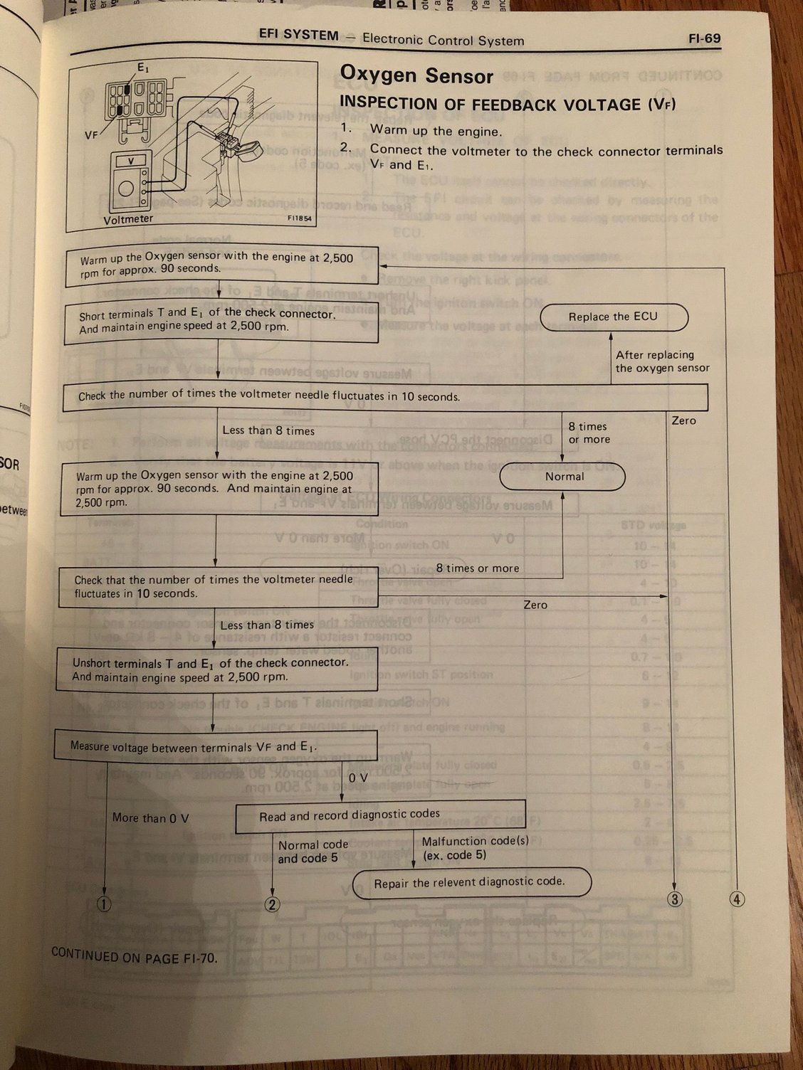

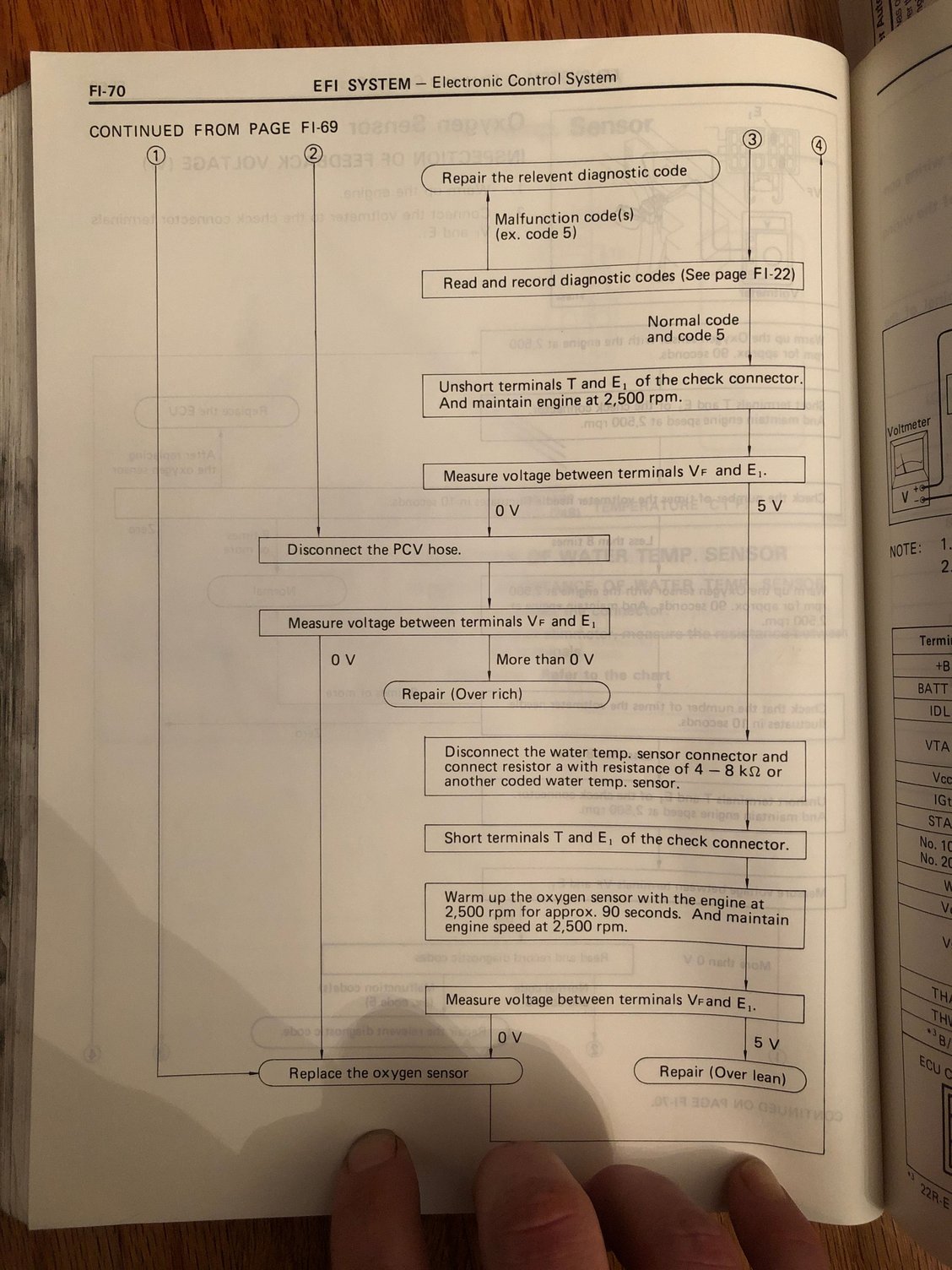

oxygen sensor test/logic map via 1987 fsm.

Thanks for the pics from the FSM!
I understand with the wiring.
Plan to do some testing tomorrow.
Update:
Tonight I did try a cold start with the PS/AC idle up valve capped off and there was no high idle at cold start. Think I can cross that off the list, although not related to the poor mpg.

Update:
O2 sensor checked out.
Voltage/resistance at ECU checked.
Coolant temp sensor, voltage was below the range (slightly) and resistance was a little higher.
FSM voltage range (0.5-2.5v), meter read 0.43v.
FSM impedance range (200-400 ohms), meter read 467ohms.
Not terribly off but the physics check out.
