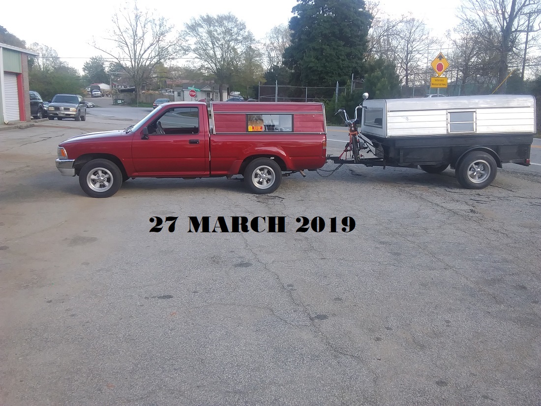

I would like to put a set of air shocks on the rear of my truck to help hold the ass end up while I have him loaded. I haven't been able to find any. Any help here?

As it is, if you zoom in on the pic of my Yota and look at my springs, you'll see I have wedges between the helper spring and the regular leaf spring. These are held in with hose clamps and are only used when hauling a load. They do the job but it's a hassel installing them and then removing them after I get back home from the swap meets.
