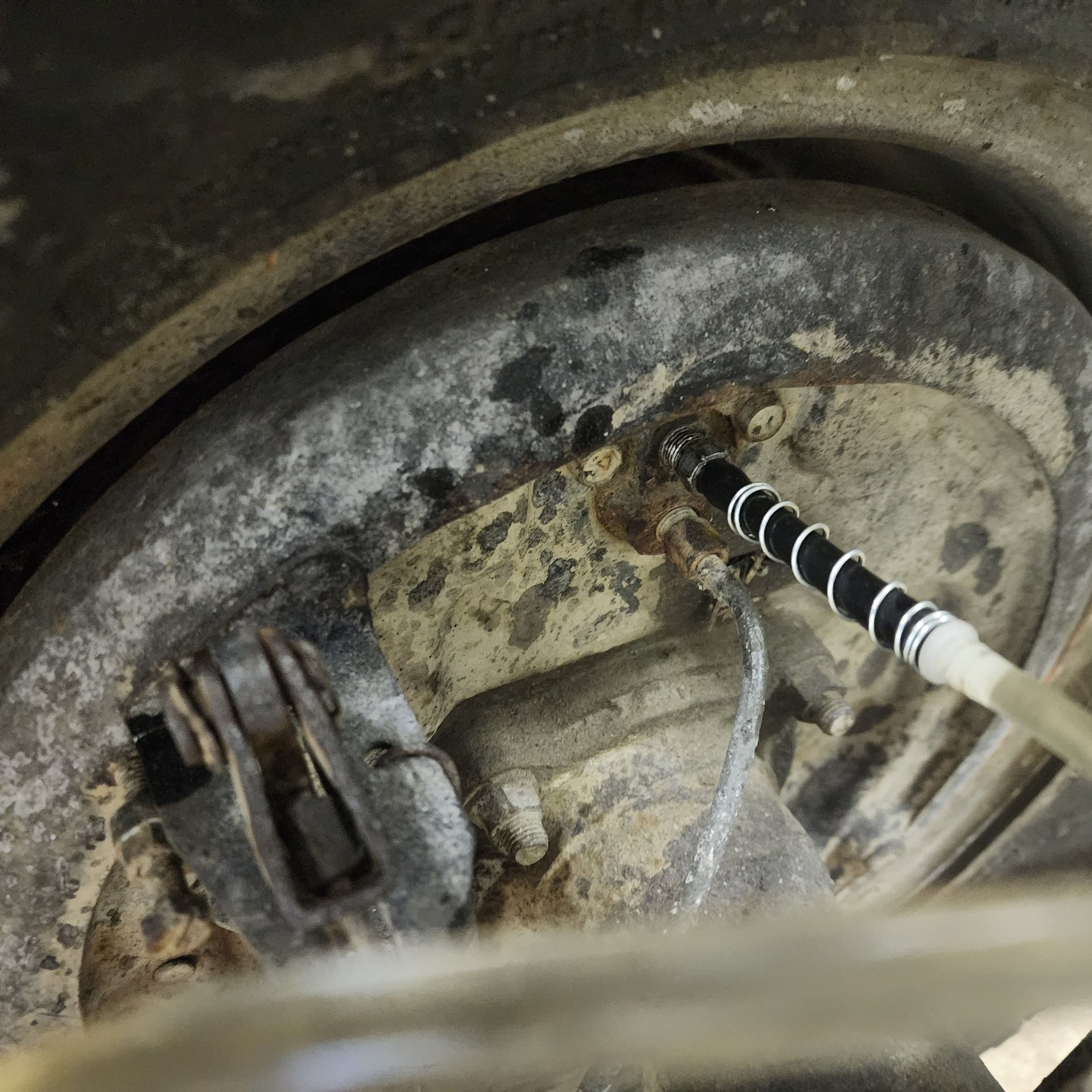

Hey all, have a rear brake issue here. Truck is new to me so don't know any of the rear brake history, but I have no rear brake movement. My first step was to try to bleed the right rear cylinder the old fashion 2 person way, no fluid would come out, tried the drivers side, no fluid, went to the proportioning valve bleeder, all bleeds correct, no more bubbles. Tried a one way valve on both rear wheel cylinder bleeders, nothing. Hooked up a vaccum pump to both sides, no fluid. Now I would normally think a broken line or something but I've got the bed off and can see all lines, nothing looks damaged. All I can think is the portioning valve. I put an extra bleeder I had into the threaded hole to see if I was sucking air there too but no luck. I'm stumped, anyone have any thoughts?

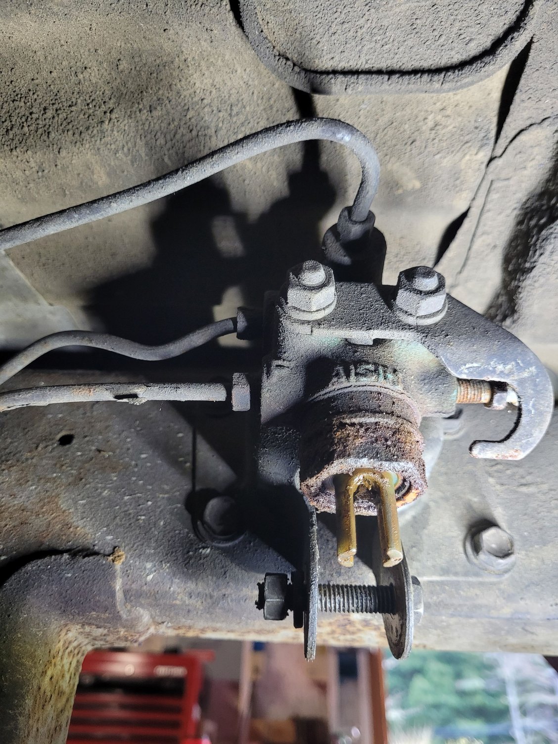

I have a return line on mine. It should tie back in under the passenger side wheel well area. Here's a pix of what my old one looks like. Still waiting on the new one.
