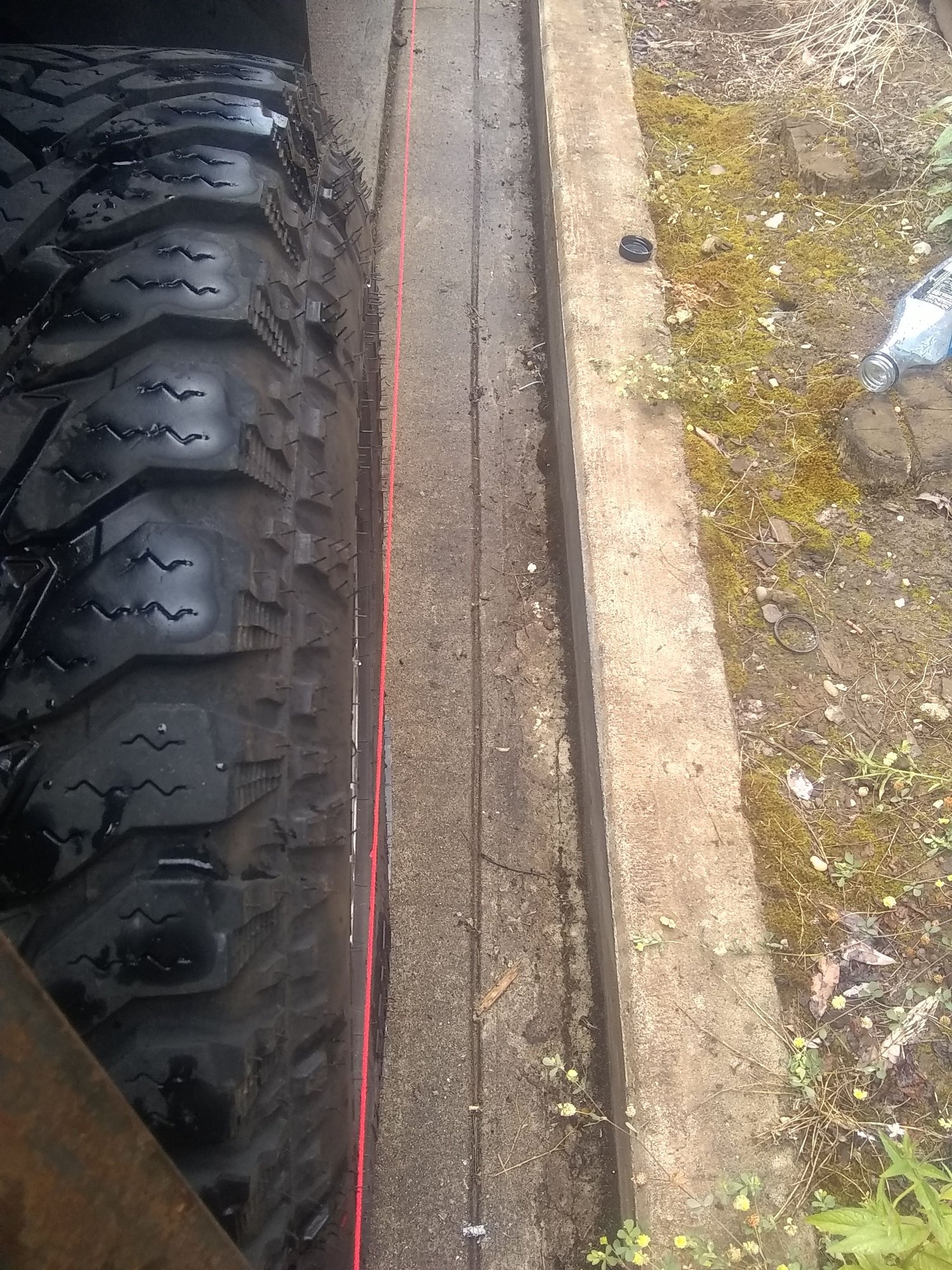

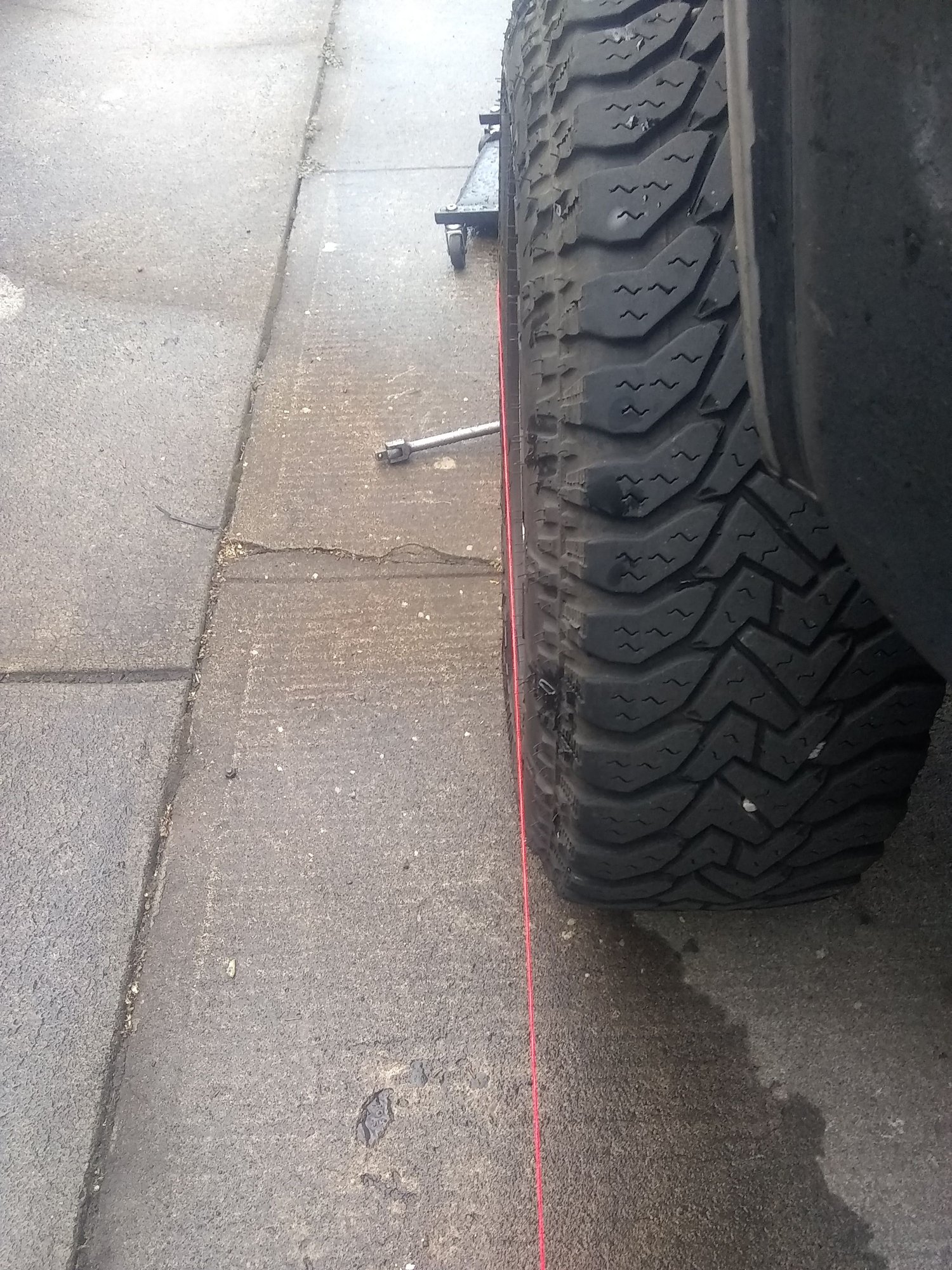

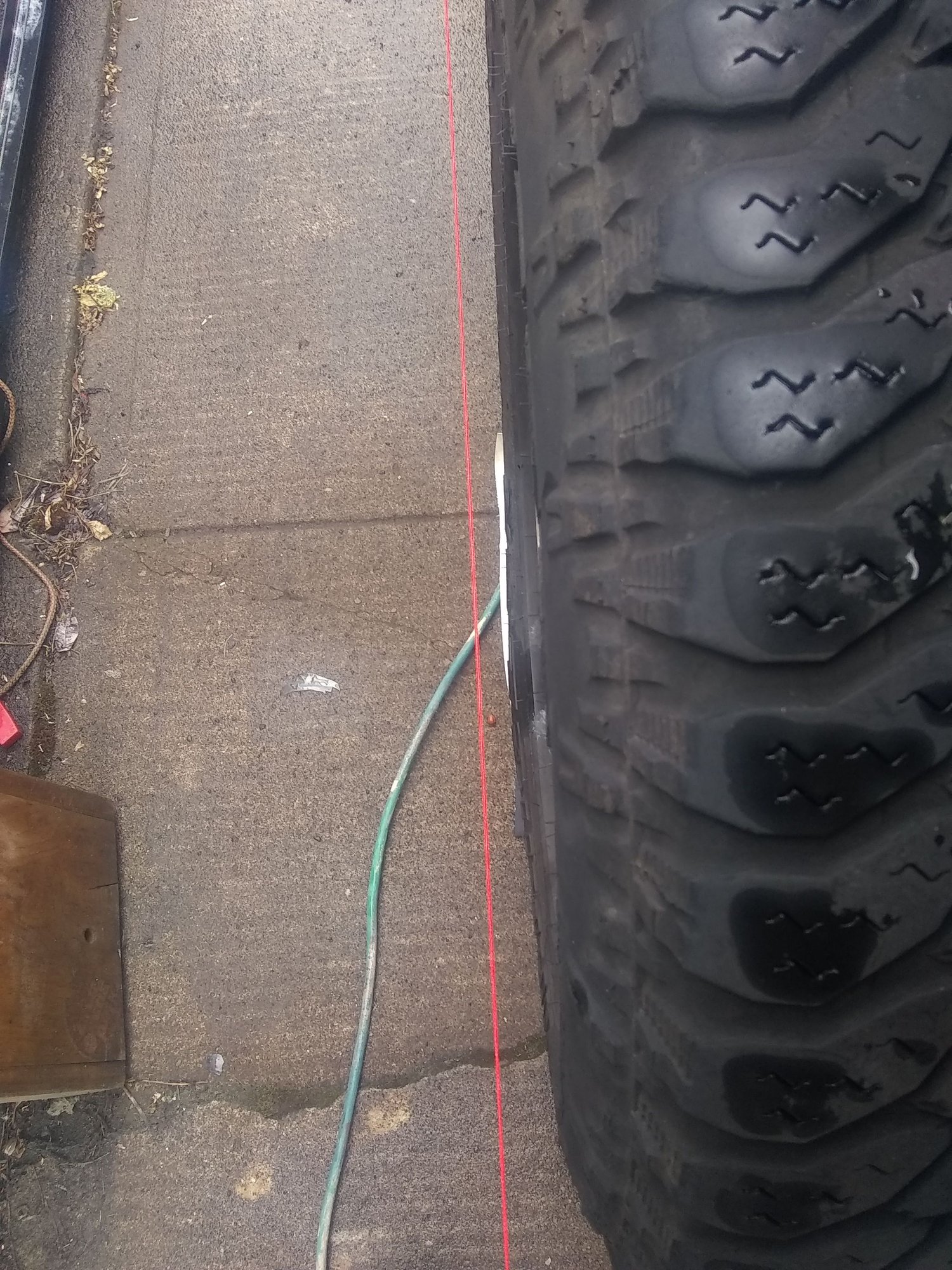

I've got a 94 pickup 4in lift and I've noticed my rear axle is sticking out further on the passenger side than the drivers,I haven't four wheeled it or really hit any thing,I measured from the front of leaf spring to front of axle and its the same on both sides,it is lifted with blocks but the 3.0 doesn't have enough power to dislodge them,they're sitting where they should be,I attached some pics any ideas would be appreciated

What I did was run a string from the front drivers side wheel around the back wheels and up to the front passenger wheel,i took and moved the string out until it was just barely touching the front sidewall of the rear wheels the drivers side touched ther sidewalls on the drivers side,they are aligned but the front tire on passenger side is about 1/2 in off,heres my artists rendition,I will pull some measurements tomorrow

Are you assuming that the two corners are exactly 90*? this isn't a good way to determine much of anything.
you aren't taking into account that the front end has "toe in"
you haven't attached any pictures that help in any way to see one wheel sticking out farther than another.
I think you need to go to an alignment shop and get some real measurements.
