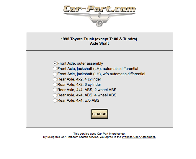

I guess I'm wrong. car-part.com breaks it down like so:
Old Oct 6, 2017 | 05:37 AM
gyoas759's Avatar
Posts: 73
From: Grand Valley, Pennsylvania
That's the break down I saw. Car-part interchange only lists 94 and 95 4runners as compatible, but I know from working on Subarus that they are usually limited by matching part numbers and not just fit. ABS rear axle shafts have a toothed ring inside the shaft from the bearing for the ABS sensor. But I don't need ABS - just want the truck back on the road. So if I can slap a non ABS axle in there and drive, I'd be happy. Didn't know if anyone had done it before. These trucks are often cobbled together from multiple trucks so i'm sure someone has tried.
