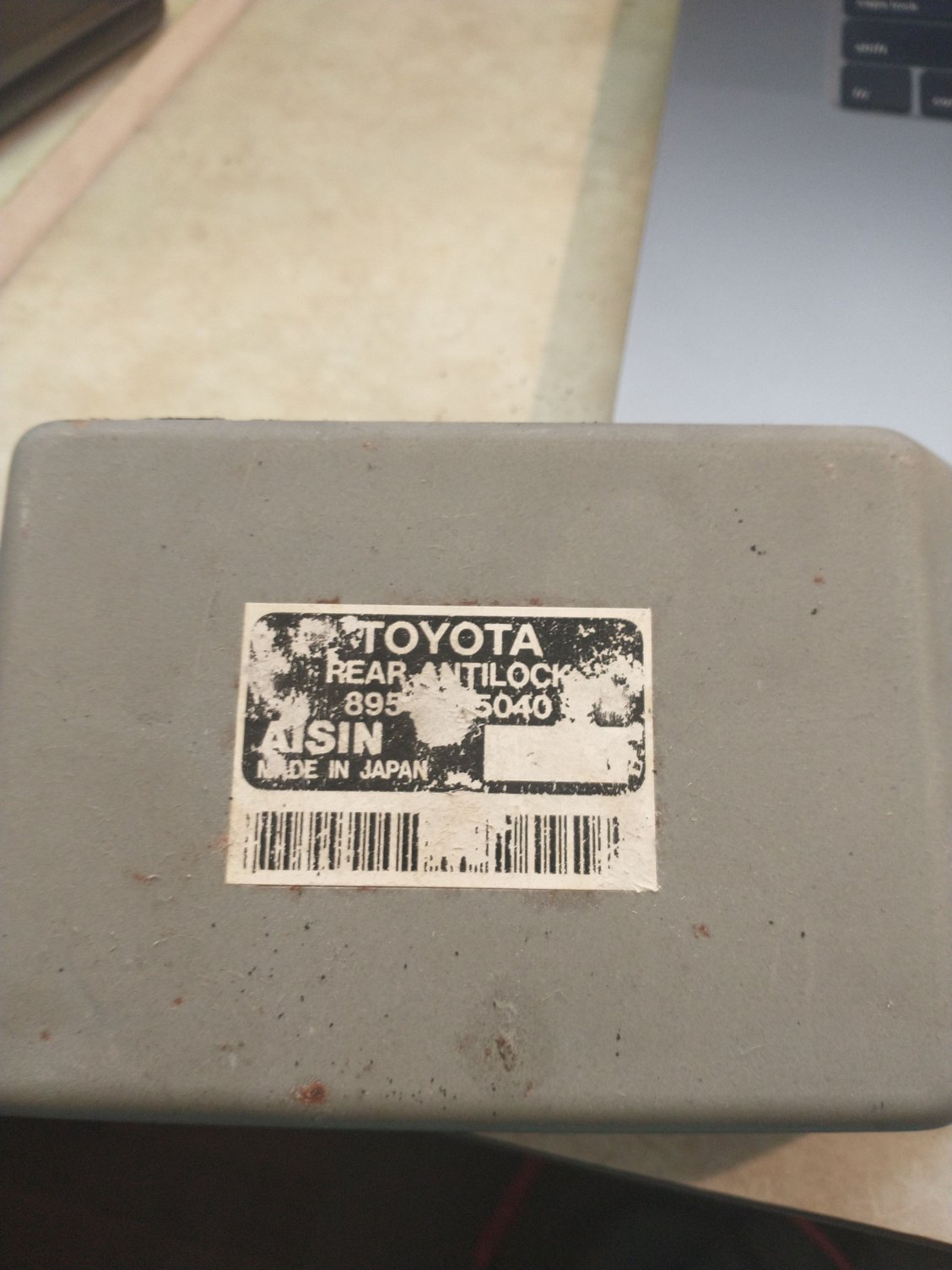

Here is the service connector that I disconnected. It's on the passenger side in the back left corner. Is this the right one?

Ok everyone, all sagas must come to an end at some point - and this one has. I found a solution. Posting here for all past/current/future 2nd gen 4Runner lovers in the same situation.
The problem was a bad ABS module. Since this is the brains behind the ABS system it makes sense that I wasn't able to read any codes and wonky things were happening like the CRUISE light flashing when I tried to read the ABS codes. I was very diligent with instructions so this was definitely odd but it makes sense in retrospect that a bad ABS brain was causing this behavior. I took the ABS module out from behind the glove compartment and opened it up. Well guess what I found. A bunch of burnt up components - mainly one of the capacitors was fried. I bought a new one on eBay for $29.00 and soon as I installed it and turned the ignition the REAR ANTI LOCK light starting behaving properly (according to the FSM it should turn on for 2 seconds when turning the ignition and then disappear).
