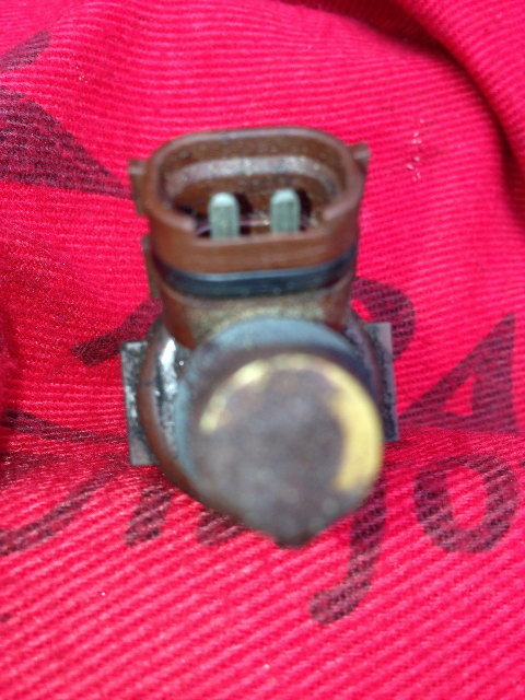

And the culprit was injectors they looked like they had mud in em. Went ahead and cleaned all of them she purrs like a kitten now.Thanks for all the help!
