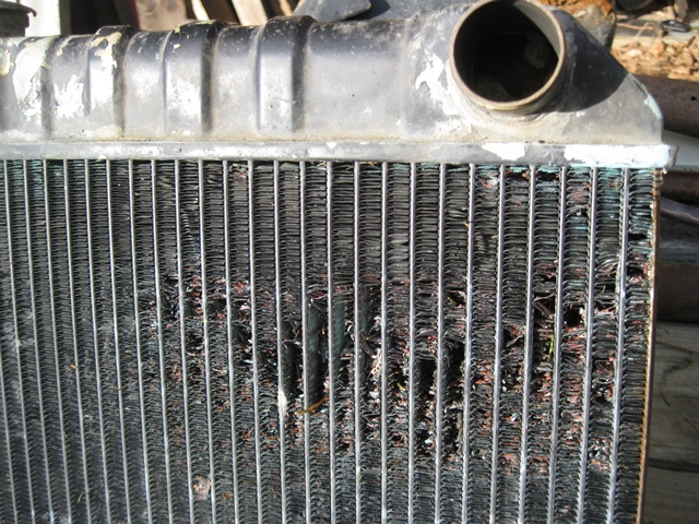

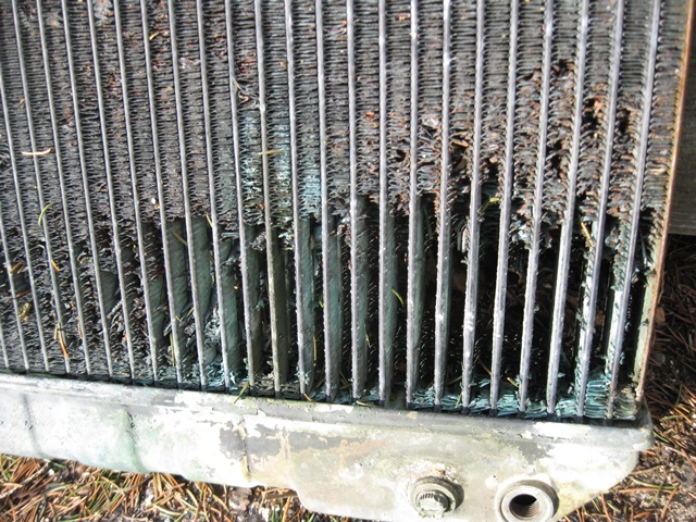

Repair and learn
I never understood the importance of corrosion inhibitors. I'm only guessing they don't last, and due to pinhole leaks, acids broke down the fins? I replaced this soon after the gauge started running towards hot and was not aware how many fins were gone under the shroud. Still, it was a satisfying repair-off to China with it.
You must live somewhere that uses a lot of salt on the roads,or at the coast. That or the the truck at one time spent a lot of time in those conditions. The only time I see radiators that have that kind of fin rot are from the coast because we don't use salt where I live.
