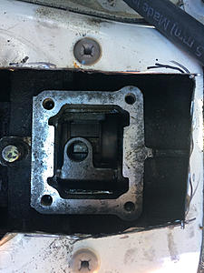

Hey,
Odd subject but i have recently just finished up a engine swap in my 2nd gen surf (4runner). I have chosen to go with the 1KZ with a mechanical fuel pump. Any way i have had to swap the transmission out to a R151f to handle the extra power, problem is im having an issue finding a retainer sub assembly for the transfercase lever. I have been to Toyota and all they can seem to come up with is one that i already have from the old transmission that wont fit. The bolt pattern seems to be the issue here, i will add a photo to this post. If any one has any suggestions that would be epic!
Cheers
Callum.

You are giving Your Toyota parts people the VIN of the vehicle your transmission (R151f) came from ??
Your using a Transmission and Transfer case from the same Donor Vehicle ??
Unless you do there is no way for them to find the correct part!!
The trouble with doing swaps some end products till finished you might have 3 or 4 VIN`s to keep track of.

Well i bought the Transmission from a scrappers, as far as im aware its from a vzn130 but im not able to get the vin num...

Marlin crawler has a billet unit thats wonderful. I have one myself.

OP is in New Zealand, but marlin will ship there
