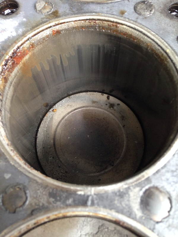

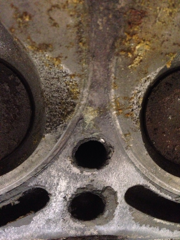

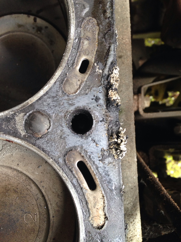

Progress!! I got the head out. Even from a novice perspective it's not looking good. There is metal corrosion on the exhaust valve side of each cylinder at the head. So in the LEAST a new head is in order. But while i'm at it, i would assume at least new valves might as well happen. 22re performance sells a stock for $550 or performance for $850. I know they're good stuff but i'm a cheap skate when i can be.
Questions:
Is the performance head worth it? I'm not a drive fast everywhere type but i do like extra power when i want it.
Any other recommendations for who to buy a head from?
Aside from gaskets, what else should i aim to replace for reasons: A) not having to take the head off for a while for repairs and B) maybe to get a little extra power.
How do i identify a burnt valve?
Thanks Again
