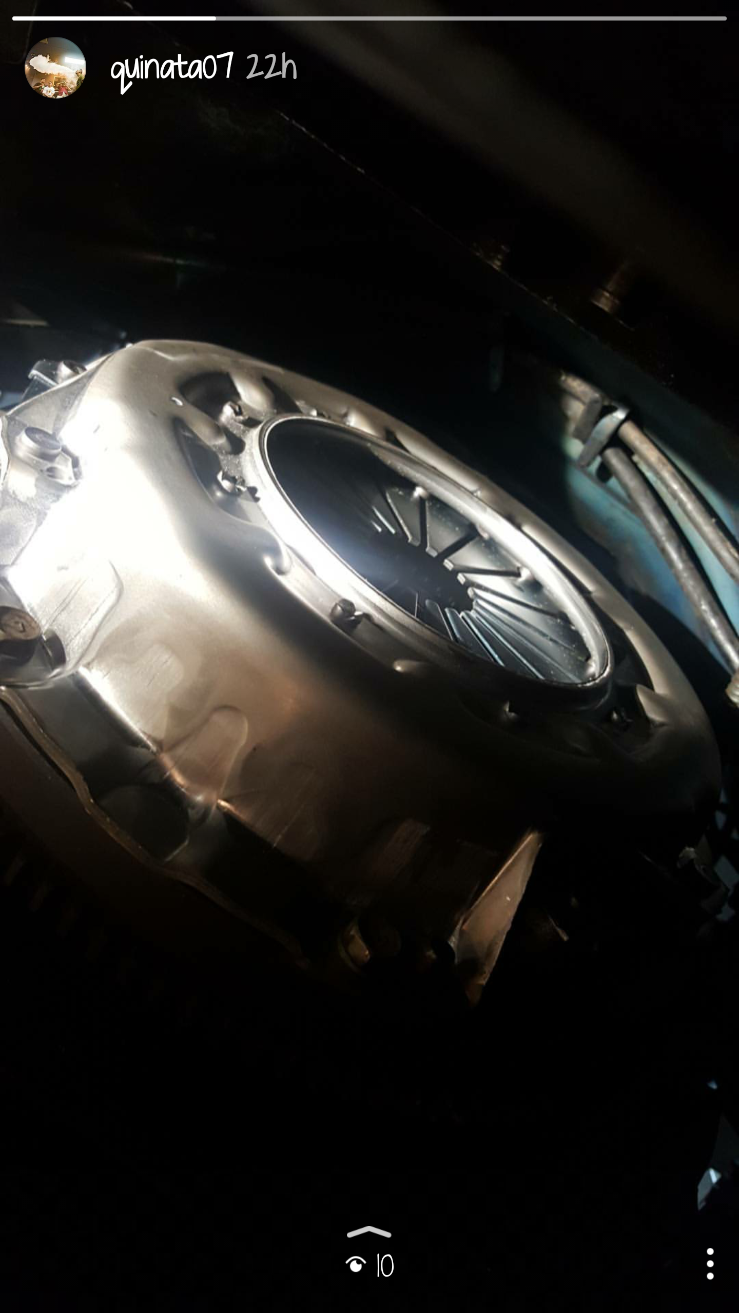

Would their be a problem if i tighten the pressure plate its not to spec just tighten my forks sits flat

It's not clear what you want to tighten.
Please explain more thoroughly.
Pics might help.

I tighten the pressure plate but i didnt tighten to
spec i just tightend it down are the fork on the pressure
plate suppose to sit flat as shown in pic

The spring does look a little flat.
The pressure plate bolts need to be torqued to spec in order to insure that they don't come loose, but if you have already tightened them enough to pull the pressure plate down tight to the flywheel,
it's not likely that further tightening will raise the pressure plate spring.
Are you sure that the pressure plate and friction disc are correct for your application??
The friction disc is in there right???

Yes it is made for my applications i even matched up pressure plate at napa friction disc is facing the right way and pressure plate is tight on their..so is my forks supposed to be like that im pretty sure that the plates not going to come loose as they are tight but not to spec just tight

I don't know what to say.
Maybe someone else has something.
Maybe it's OK,, IDK.

Originally Posted by yota671
So is the pressure plate right ?
I am not sure.
If the tranny is not yet installed, reinstall the old parts and examine the difference, if any.
If tranny is already installed, test clutch for function.
Sorry I can't come to look; Guam is a far piece.

Yes i know but dont u think 14 ft lbs is not enough for something thats constantly spinning if its spinning all the time u wouldnt want it to get loose...too late on taking everything out i have done it 3x already its all hooked up trans on front and rear shafts etc..i been googling and i see pics where the plate sits like how mines sitting well i wouldnt know yet untill i try it out got to hook up master and bleed slave

Originally Posted by millball
.... Once you are a mechanic with long experience, some things just come naturally, like proper tightness of various sized, less critical, fasteners....
Yeah, yeah. How does that go? "Good judgement comes from experience, experience comes from bad judgement." How many times have you seen someone (who claims lots of experience) do something really boneheaded? Experience is a good thing, but I prefer to see it in writing when I can.
Yes i know but dont u think 14 ft lbs is not enough for something thats constantly spinning ...
Yeah, what do those egghead engineers in Tokyo know, anyway? Sure, they've designed millions of vehicles that have lasted for a very long time, but I'm sure you'll "improve" matters by tightening your bolts a lot more! Just to be sure!
If THE BOOK says 14 ftlbs (kudos to you for at least looking up the number), that's what you should do. They aren't really hefty bolts; if you over tighten them they will break. Maybe not while you have it out on the bench, but soon, and at the worst time possible.
14 ftlbs isn't a lot; I don't think I could get real close "by feel." That's why I have 3 torque wrenches (1/4", 3/8", 1/2"), so I can hit the small torques as accurately as the big ones. (and, for what it's worth, I have them calibrated.)
