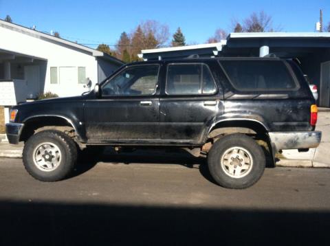

First off I would like to thank all the guys on this forum who helped me with information on replacing the stock coil springs on my 94' sr5 4runner with FJ80 rear coil springs. The rear fenders were 33" from the ground and with the new springs in there they are barley shy of 38". I really liked the way it came out and it looks great. I will be doing ball joint spacers in the front since the nose will need to be raised a little. If anyone has any to sell please pm me asap.
Due to financial constraints I have yet to put new shocks in. Right now I have Ranch 251D shocks and I believe they are maxed out, therefore not being utilized and I am only getting cushion from the new springs? I am assuming this is why the ride is so incredibly rough? What are my options as far as new shocks go? I do not need the top of the line since I do not 4x4 all that much. I would like an affordable shock that can help to increase the ride quality because right now I feel every little thing and if I let go of the wheel the car will want to go right and left? Is there anything else I can do to make the ride any smoother?
Below are some before and after pics of how it has turned out so far.
If this thread is similar to something I appoligize, I have searched but to no avail.
Thanks for the help..
Attached Thumbnails Post FJ80 spring installation questions....-runnerlift1.jpg   Post FJ80 spring installation questions....-runnerlift2.jpg
Yep if your springs want to go higher than the shocks allow you aren't using either one at the top of the travel.
Anything you want so long as they are longer. Weight down the back end or jack up the axel, so you can release the shocks and then measure the space between shock mounts.
Of course it dawned on me these are coil over systems IIRC so thats not going to work. The local 4x4 or suspension shop should be able to get you sorted. They should be able to look up the spring length.
In essence you need shocks that are longer than the springs.
Full alignment should fix this, the caster angle has changed with the difference between rear and front. If the shop tells you they can't adjust it you need to find a better shop
