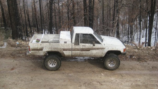

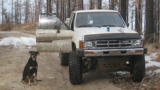

Here are some pics of the offending vehicle.
