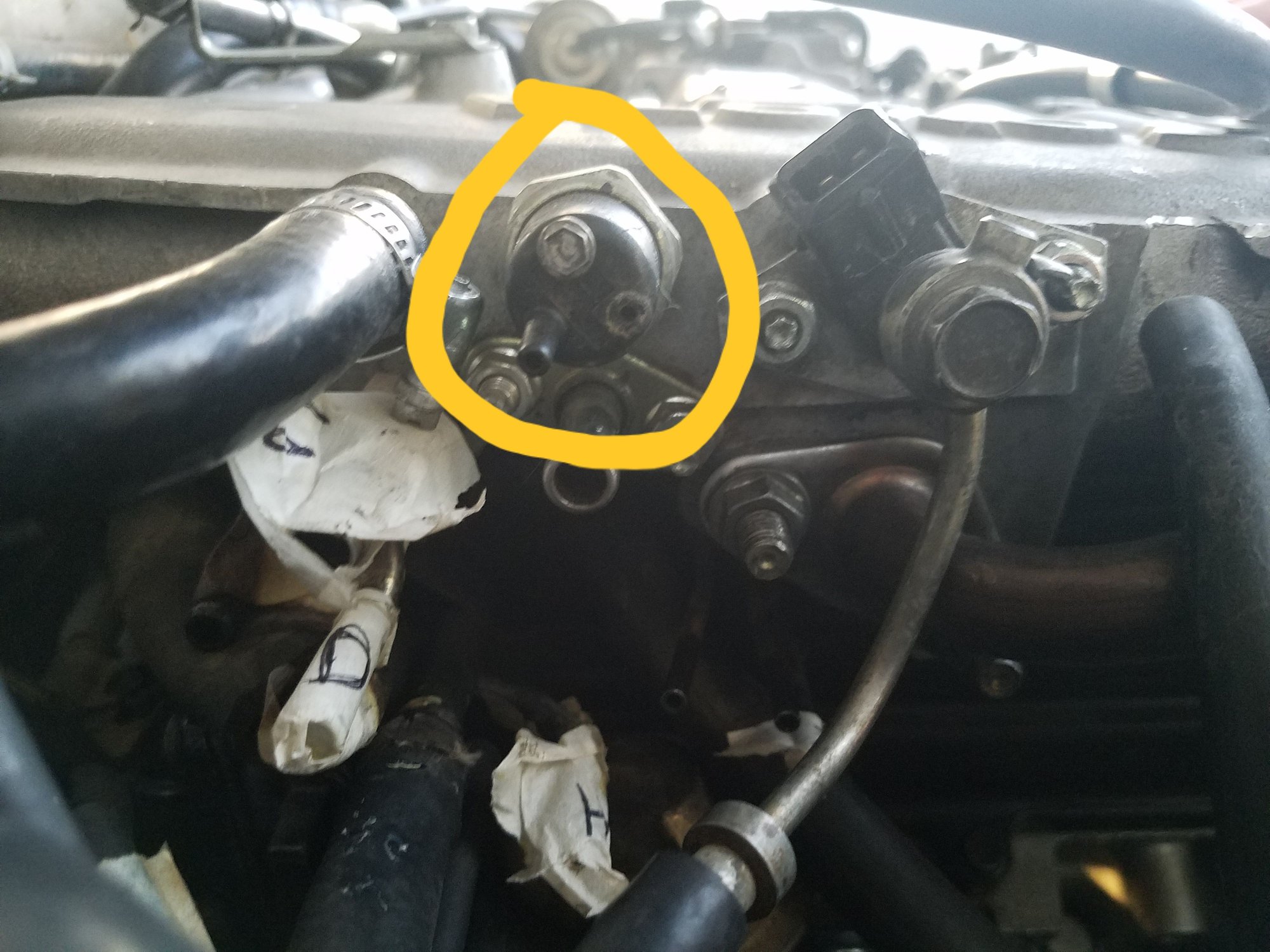

Hello all! I need help identifying this part. It is circled in the picture, I accidentally broke it off and now need to repair it. Thank you!

Filter, ,Gas No. 1 90917-11027
https://parts.lakelandtoyota.com/showAssembly.aspx?ukey_assembly=520011&ukey_make=1 060&ukey_model=15426&modelYear=1995&ukey_category= 21648&ukey_driveLine=6747&ukey_trimLevel=18292
It looks like yours was buggered up anyway with a screw blocking one of the three ports. Depending on your options (e.g., A/C, 4wd), that port is sometimes covered up with a rubber piece. On mine, it supplies vacuum to Cruise, ADD, AC idle-up, PAIR, and Fuel Pressure-Up.
Do you know what you are missing?
