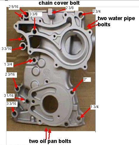

I'm pretty sure it's the one in the very center right above the oil pump that can touch the tensioner.
When I put mine together I could take the valve cover off and look down at the tensioner with a flashlight and see the end of the bolt sticking in. The tensioner has a small notch to allow this, but I went ahead and ground the bolt down so it didn't protrude at all.
You can most definitely see it sticking out of the cover right at the front of the tensioner if you look in there...
