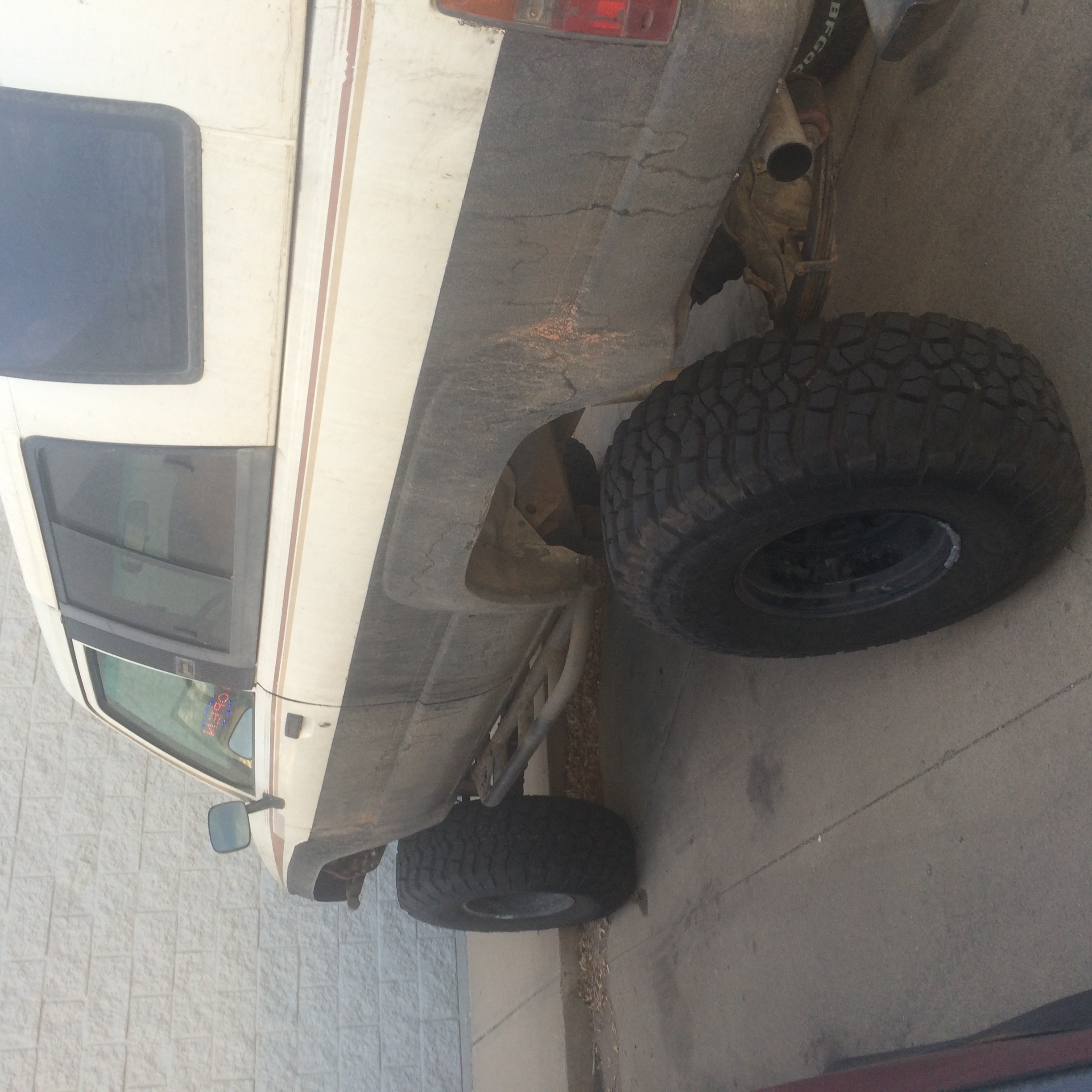

Here is the best I've got at the moment. I'll take some more later when I'm done in the shop. Trying to get a customers rig out the door.

Sorry about that...

Another. Sorry for the dark front corner.

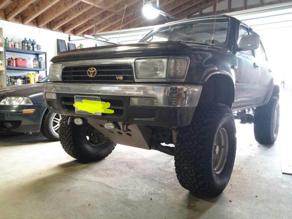

Here is a front on pic to show how far the tires stick out past the fenders. My wheels are 15x10. Not sure of the backspacing yet though. I am doing ball joints tommorrow so I'll measure it then. If I had to guess though, I would say maybe a 3.75" backspace...probably wrong though.

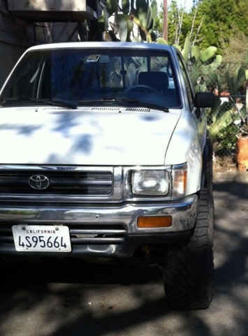

Not running a 4" bracket lift, but here's a good example of how far 33x12.5" tires will stick out. Mine are on 15x8-3.7"bs wheels. My lift is BJ spacers and t-bar adjustment, all 4 corners are at 22.5" center axle to bottom of fender. If you get 33x10.5s and stay with stock 7" wheels, you should be able to keep the tire covered without getting flares. Sucks to hear about the new law, I guess there goes "Hawaiian-style tires" lol/yuck...

Thanks this is exactly what i was looking for. Yeah the new law sucks but guys still run their "Hawaiian-style tires." Some guys do recon some just risk the ticket. But i just want to stay legal so i don't have any problems at all. Thanks again bro

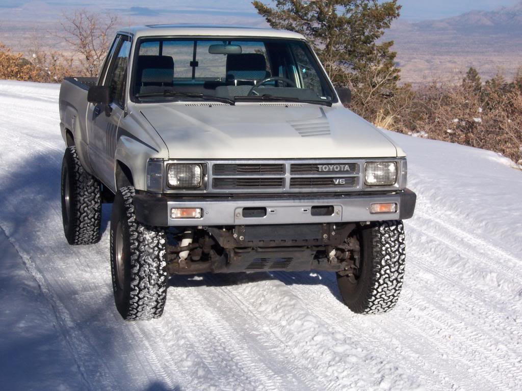

33x10.5 on 15x7 SR5 rims. BJ spacers, 2' rear spring and a 1" body lift.
