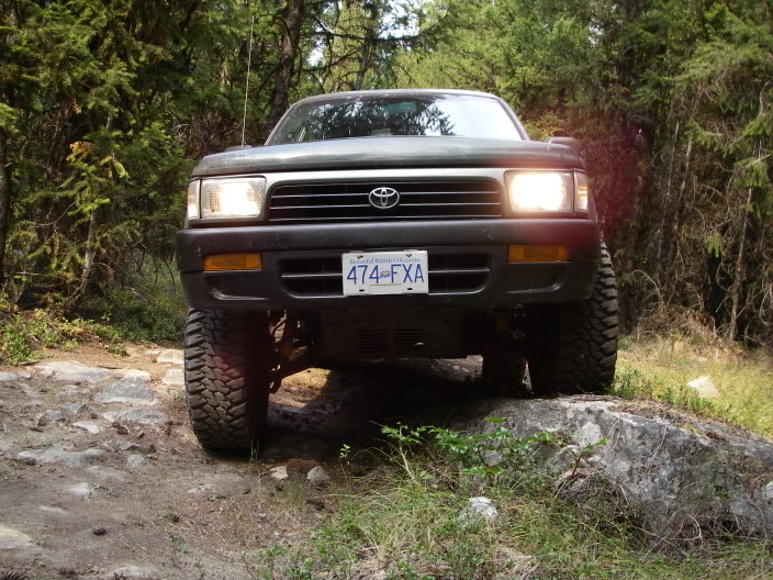

hey sweet jumping pic , i don't have any pics from the rear have a side and front though , Name:  IMGP0032copy.jpg
Size:  79.5 KB Name:  IMGP1500.jpg
Size:  129.1 KB hope those show them well enough for ya

Mikes350...thats a SICK truck...whats your offset on those 8" rims.!!!

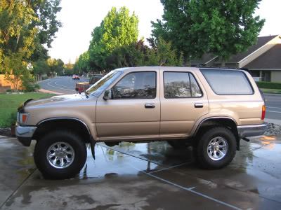

those are 32x11.50s on 15x8 eagle allows with 3.75bs

hey mikes350 did you paiint your rear and front bumper black? If you did I think it looks WAY ÅÅÅÅing kool! right on. Could you tell me what you used if you did and whats the easiest way to do it? thanks

hey hill those rims are 3.75 back spaced , the front and rear bumper are painted with duplicolor truck bed liner , to do it i removed the bumper , sanded it to remove a bit of surface rust that was forming , i sprayed it with a rust inhibitor first then with the duplicolor truck bed liner , pretty easy process and i really like the end result , i'll see if i can find a close up picture
