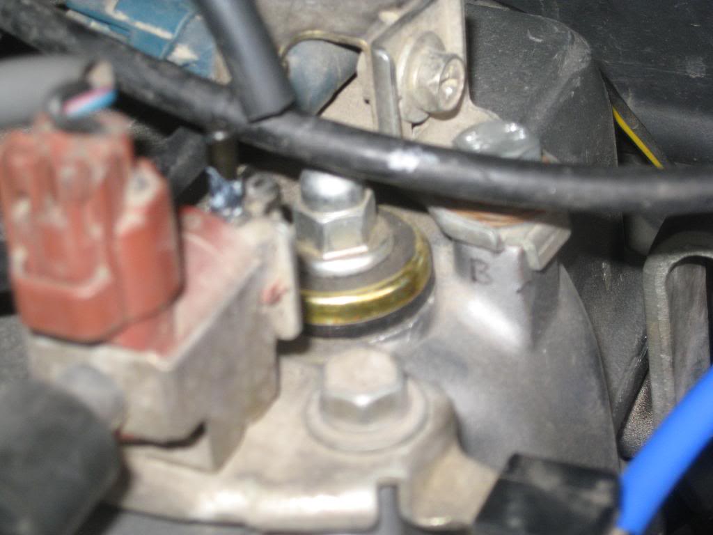

This is how the vacuum hose and check valve were positioned before the (I think throttle cable) broke off the nipple that accepts vacuum from the intake manifold.

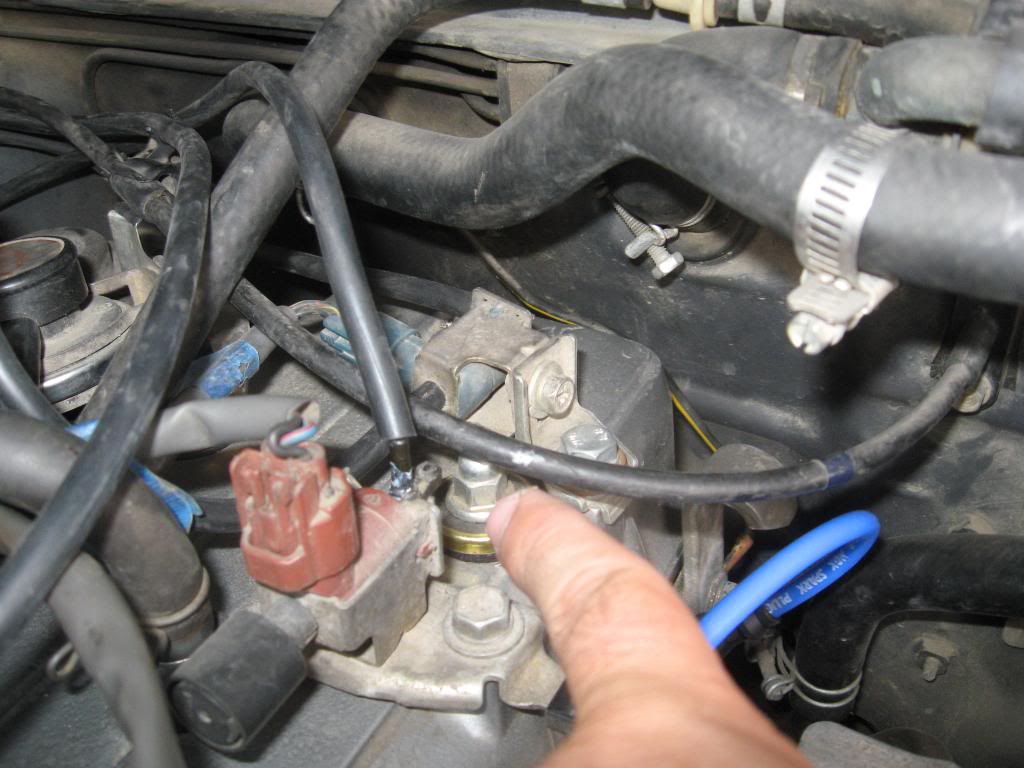

Another close up shot.

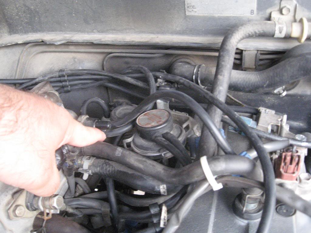

I then took off the vacuum line from the unbroken nipple that runs from the VSV to the reed valve below the intake.

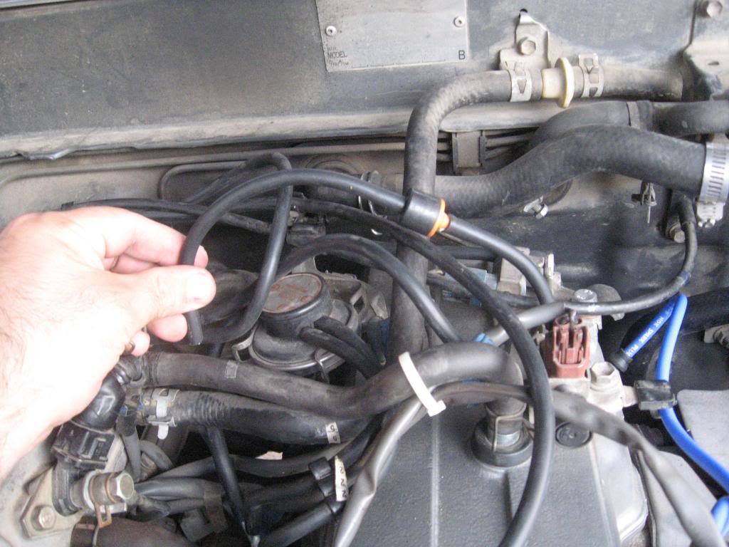

Then I just hooked up that vacuum hose to the port on the intake where the line with the check valve went into. The reed valve of the P.A.I.R system is now effectively receiving manifold vacuum all the time now.
After looking through the FSM and putting everything together, the VSV receives a signal from the ECU when decelerating and at WARM idle only, to cut vacuum to the reed valve. Otherwise the reed valve is "open" or receiving vacuum at all other points. When the valve is open, it is injecting air into the exhaust to promote proper burn off in the catalytic converter. When the valve is closed, no air is being fed into the catalytic converter, due to I think, not overheating the converter. So I guess the downside to this is you may have higher catalytic converter temps. I have an inferred thermometer that I will take temps of to see just how hot it gets at warm idle.
