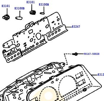

I am prepping my new to me SR5 instrument cluster for installation and want to replace all the bulbs before I install the thing and find out half of my lights don't work. I was able to get the larger bulbs (GE 194) does anyone have a part # for the smaller bulbs? The vehicle being discussed is an '89 Pickup (first year of the 22re with the rounded more tacoma like body)

If its the one labeled 83100B the p/n is 90981-11018
(BULB, COMBINATION METER, NO.1 - 12V 1.2W W/O SOCKET,W(TRIP METER & TACHOMETER)
The dealer has them for less than $3 each...as painful as that is. Take a bulb with you to be sure. No cross reference to an over-the-counter version though.

IIRC the smaller bulbs are #74's. possibly a #158.
