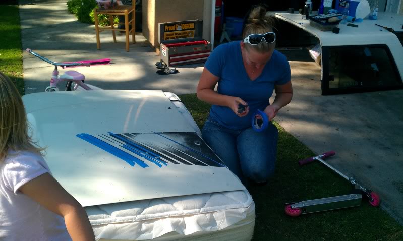

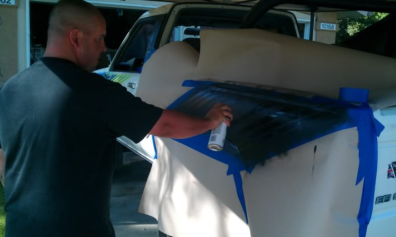

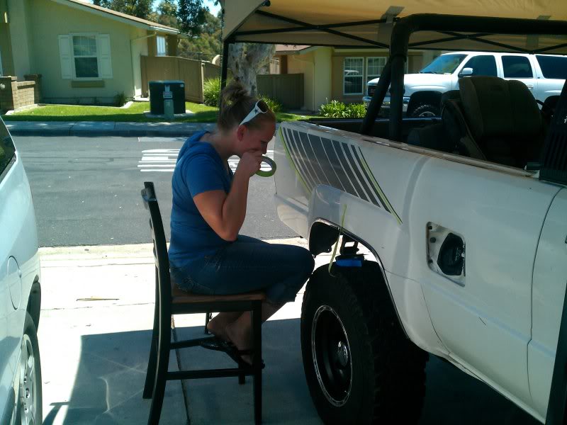

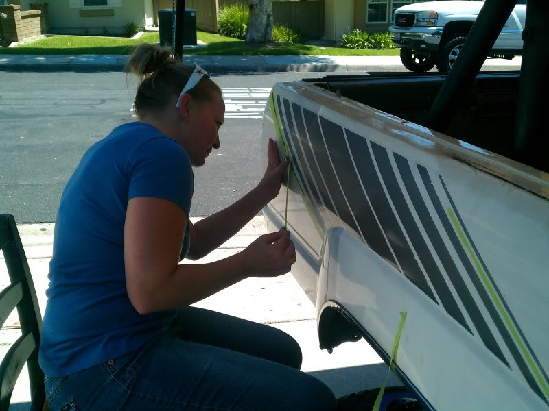

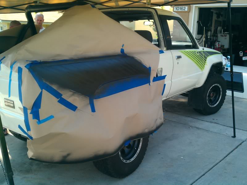

painted the stripes, grill, bumper, and rear fender rock guard
The old stock stripes were silver, faded, and chipping off. Instead of trying to track down some stripes or getting rid of them, we just masked them off and painted them. My awesome wife has more patience than me so she jumped on the masking work while me and couple buddies handled the paper, body pieces, and painting. This was done with some semi gloss black from Autozone and I'm pleased with it. Also, I've never seen black stripes, always gold or silver.
Along with the stripes, we did the front bumper, grille, and the plastic rock guards on the front of the rear fender wells.

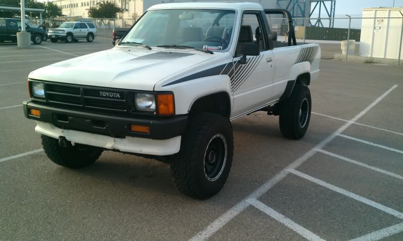

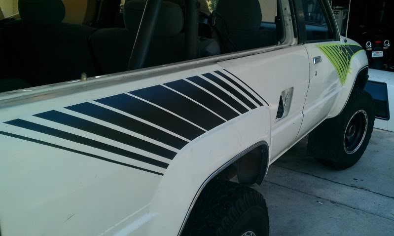

Like is said its no professional job, but I hate chrome and I'm pleased with it. It's slight differences from other trucks that make it mine. Now time for a back bumper/hitch.

Nice! It turned out great with the black on white theme.

Thanks guys! Im in love with it. Like i said, just a different color of the factory decal. Cheap spray paint bonds to the old vinyl really well actually. The old vinyl isnt really going anywhere after 24 years of baking onto the truck so painting the vinyl was just plain easier. If it fades, Ill redo it. A couple of hours of work and $18 is easy to duplicate next year or whenever it needs it again. Chrome isnt easy to cover up so Im fully expecting the front end to need repainting before the stripes. Still though, as cheap as the whole deal was, I dont mind touching it up.

Im still floored at how much of a difference the black made compared to the chrome. Especially around the front amber lenses. They pop out now where as before they were just kinda there.
