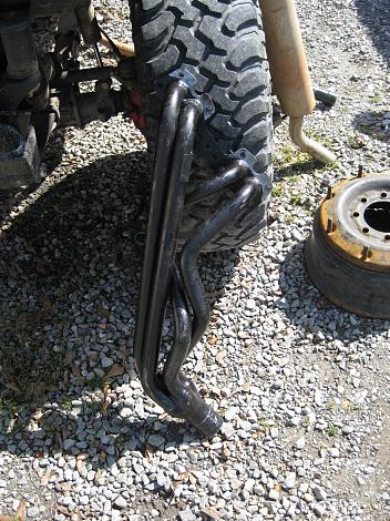

I just welded all the holes up!
Attached Thumbnails Pacesetter header fitment issues.-picture-005.jpg   Pacesetter header fitment issues.-picture-011.jpg

haha Indeed you did. Did you completly remove the EGR or just crimp that end right there haha?
Thats the air induction tube got a block off plate on the way.

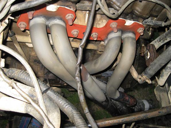

Old Apr 8, 2010 | 04:03 PM
akaphilly's Avatar
Joined: Jan 2006
Posts: 460
From: Cape Cod
k forget waht i said earlier. now i remember. it was leaking bad with the pacesetter gasket. and since the bolts would not line up i filled them with rtv. after about a month i took the header off and the gasket fell into peices. i looked at the stock gasket and noticed it did not have holes for bolts where it was leaking before.(center hole in pic) so i threw it on and everything has been good since. no leak
