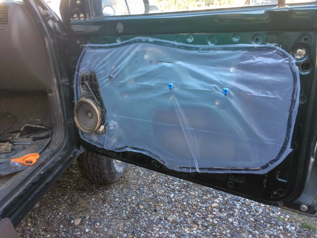

It's running great! I'm using it for errands and local coyote hunting, everything works. Woo hooo! THEN,,, I go out back, get in and start it to warm it up. Later go out back and drive it to the front so my hunting buddy can load his things into the back when he arrives. He arrives, I go outside and immediately break off the @#$%^&* door handle when I try to get in the driver's door!
I fixed that myself by replacing the handle on both sides using dorman parts. Also replaced the plastic sheet inside (original had been reduced to confetti).
