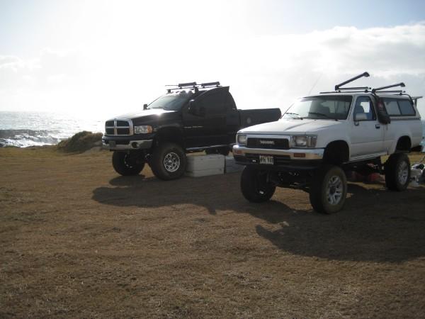

wow 1000lbs in a yota!! you puttin that bad boy to the test ha. i carry roughly 500 at the very most. so i guess the mediums will be perfect. the reason for the block is that the front of my truck has a procomp lift, bj spacers, and downey torsions (which i might end up pulling out and replace with stock torsions). with no tb crank. so ill need the block to make up the difference in the rear.
Attached Thumbnails OME rear leaf spring owners-l_b8b93c0fcc1b4c06a5328c5db594ab3d.jpg
Old Dec 3, 2010 | 07:53 PM
  #23
joshuapc's Avatar
Joined: Feb 2008
Posts: 121
that pix is saggy but with no load...only camper
