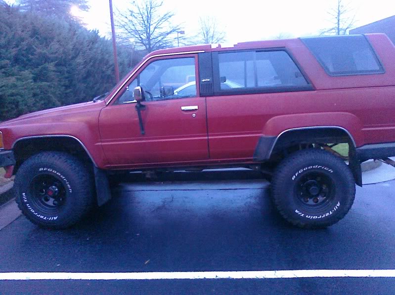

i just put in the OME cs009s with an allpro 1.5+ shackle. i got the shackles for next to nothin' from a buddy so i put 'em in. now i see there's too much lift in the back. i'd have to crank the t-bars to get it level again.
however, it's still stiff and bouncy. anything faster than a crawl over a speed bump and the back end bounces hard. its rough. my OME shocks are on the way from ARB, but i'm wondering about pulling the 4th leaf from the pack.
has anyone done this? or should i just keep rolling til they break in more, and consider putting a stock length shackle in?
maybe i could get away with drilling a hole in these shackles??? i do plan on getting a heavy rear tire carrier bumper in the future.
all advice greatly appreciated!
Tj
the rear has dropped some since this pic, but it's still high.

i spoke to ARB-USA yesterday about the leafs and pulling one out. he said the springs should be fairly broke after 300 miles. he also said my stiffness is most likely cuz i still have the monroes that are designed to match with factory springs. i picked up my OME 94s today.
he made two important points, which i wanted to put in here for anyone searching in the future.
1. if you're going to pull a leaf, pull the 3rd from the top. the CS009s are a 4 thin + 2 thick leaf pack. so pull the 3rd after the military wraps.
2. first thing he asked me was what shackle i had. i told him i have 1.5" over stock, cuz i obtained them for free, and he said that was a major problem. the springs are designed for a stock shackle length. the vibe i'm getting is most likely due to this.
so i'm either going to drill these 5" shackles at 3.5" which is stock, OR try to find some 3.5" or 4" shackles and switch 'em out. then i'll see if shimming is still required to ditch this driveline vibe.
hope this info is handy for someone someday!

the OME leafs are +2-2.5". this appears consistent with my set up. i had to crank t-bars 1" to combine with the 1.5" bj spacers and level out.
i can't confirm they're exactly the same length, but they do fit into stock perch with stock shackle length of 3.5", so i assume yes they are.

chris - the 2-2.5" of lift is supposed to be with stock shackles. the OP installed 1.5" shackles in addition to the 2-2.5" leafs, netting him roughly 3.5-4" of lift in the rear, which is why it's so raked. i've got mine with stock shackles and bj spacers up front. i loosened up my stock t-bars to bring the front down closer to stock and allow for good flex in addition to swaybar removal. my truck sits about 1" higher in the rear than the front, perfect stance if you ask me. I've also got OME shocks and steering stabilizer installed - a HUGE improvement over stock shocks and the ride is great!
