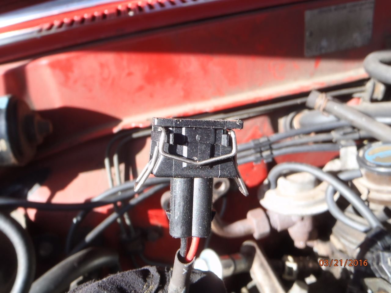

also, since you've got things apart, now is a great time to replace the injector connectors with updated ones. i installed a set from "injector connectors dot com", and these allow for easy unplugging while the rail & plenum are fully intact; useful for swapping connectors to different injectors for diagnosing. much better than the original connector design.

How do those new connectors work?

the new connectors are nice, and work much better. they have external wire clips that you can "pinch" to remove them from the injector.

Are these more an "adapter" pug one side into old connector and one side into injector? Or do I have cut the old ones off and re-splice? (sounds scary, not much wire there to work with....)

the connectors in my pics come with a length of wire. you do need to splice into the old wiring. it is well worth doing.

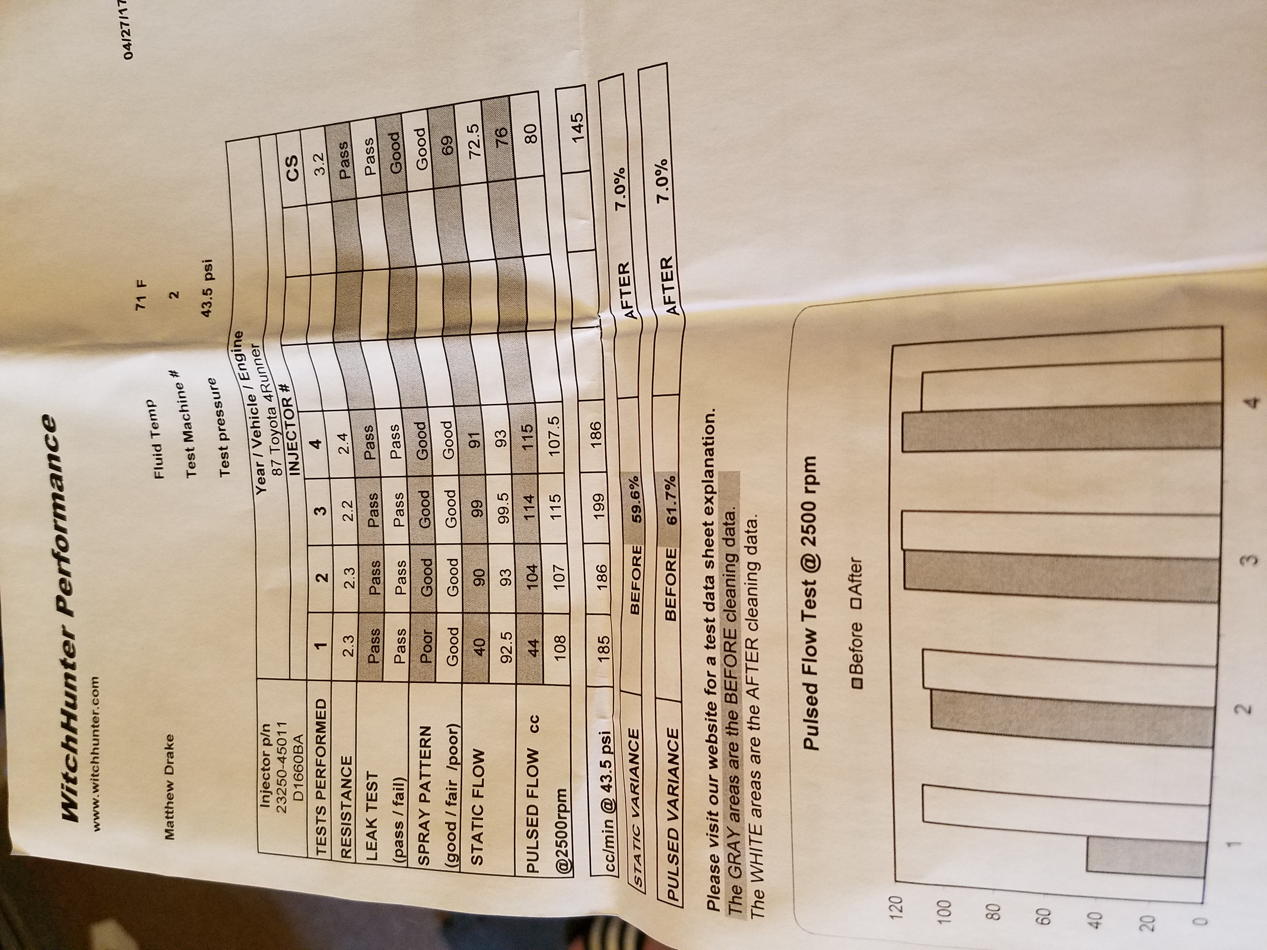

Ok, injectors came back. Something was definitly jacked up with #1. That one should be better now. Cross fingers hopefully that will fix the misfire and thus pass smog and help the computer produce more HP and thus ergo help MPG...... However, the after market #3 is a bit higher than the rest, I don't know how far the scale relates to this as a BIG or little problem???
What do we know, what do we think?
1= throw them in and be happy with results as long as it passes smog?
2= order one denso to replace #3, pass or not, and hope its closer in parady to the other 3?
3= order a whole new set from a ebay specialty company advertised as flow matched, tested, reman, warranty, blah, blah, blah, for $75.00?
4= order a whole new set from a special specialty co. like LCE, with the same blah, blah, blah but with a reputation for $200.00-$300.00?

Got it put back together and she started up. Runs alot smoother and no "bump-bump" and gas smell. Knock on wood I think I found it. Haven't driven tonight hopefully drive a bit and take a shot at the smog tomorrow.
