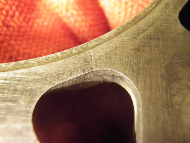

Well it looks like my truck is trying to talk to me. I'm like 99% sure I found a crack in my block between a coolant passage on #3 cylinder and the cylinder wall. well damn............that just sucks. Hopefully a build thread coming soon when I can save up some money. Pics to follow.......

you sure its a crack... its pretty rare to see a cracked block. FYI.

Drew, thanks for the advice man I think I was getting a little more excited than I probably should have been. However..........this pic sure makes it seem like this project just took a different turnName:  block.jpg

What do you guys think? Sure looks cracked to me.........

damn bro... yea that's cracked.
Yep, that's a crack- you can see how it's progressed to/from the passage over to the cylinder bore. Not a good thing.
Repairing may be possible, and thats a very iffy "may". Probably easier to replace the block... and definitely a lot more reassuring.
