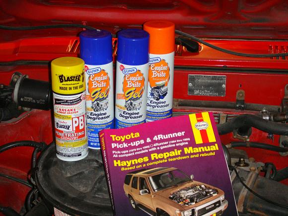

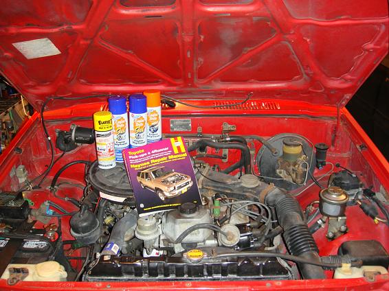

Thanks for the advice 92 TOY and Gnarly4X- thanks 92 TOY for bringing him aboard!! I did a little checking around town on Thursday and the dealership and another auto shop I trust in town gave me estimates of $220-$260 just to replace the front main seal, I was just curious. So right now I'm on the ledge... go for it and start tearing into this thing myself and save some money or ??? I guess there's not really any other options because if either of those places dig in they might tell me it's the timing chain, cover or HG! If that happens I'd be screwed $$$!
I took a picture of what I picked up below... 3 cans of engine cleaner some PB Blaster and a Haynes Repair Manuel from Auto Zone. I also went by Sears last night because I have ZERO in the tools department. All I've done to this truck under the hood was change the oil a few times back in high school and a belt or 2... and thats been more than a FEW years ago! My question is what tools should I start with? After degreasing the entire thing (not sure when that will happen cause it's 15 degrees outside right now!!!) I'm thinking that I'll start on the front main seal and possibly take off the valve cover to see what the timing chain looks like? Sound about right? As far as tools needed there are a couple sets of the Craftsmen sockets/wrenchs for light mechanic work that run up around $200 and I had no idea how much a torque wrench was. Would I need a 1/2" or 3/8" torque wrench? The cost involved with getting these tools exceeds the dealership cost to replace the front main seal but if I get these it'll maybe give me more of a reason to do some of the other stuff I'd like to tackle.
Like everyone else who's started these things I'm more than a little nervous because I've never done this stuff before and don't want to mess something up to the point where I can't get it running again. I keep reading your guys write ups (VERY HELPFUL!)... Gnarly4x, flyingbrass, txclimber- man what did it take you like 2 weeks WOW!!! and 92 TOY- gotta get you a bump you're all the way back on page 4 now! I've also read 4crawlers write up a few times.
Today I'm gonna order the front main seal from the dealership and try and make a call on some tools from Sears (they're on sale through today). Thanks again for your guys help! I'm not sure how fast this is gonna go but I'm anxious to get started!!!

Originally Posted by 86 TOY
Kind of a change in strategy in the last few hours... I talked to a mechanic friend on mine (too bad he lives 3 hours away!!!) and he suggested dropping the oil pan to get the front main seal as opposed to removing the crank pulley. Any thoughts???
Won't work. The front seal sits in the oil pump. The pan has nothing to do with getting to it.
Before getting carried away tearing into things, I'd clean everything off well, drive it some, then see exactly what's leaking. The front of your motor looks awfully clean for a leaking front seal.
