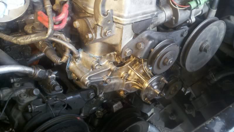

I've been having a drip or two of oil under the truck and I followed the trail up to a a point where I *THINK* the oil is seeping from. It looks like it's coming from the head/block, like the headgasket. I've had this dripping issue for quite a while and it's not at the top of my priority list. I have drained and refilled the coolant 3 or 4 times on miscellaneous projects in that time and haven't had any sign of a bad headgasket. No oil/coolant mixing and I haven't been losing any coolant. I did one compression check about 3 months ago and the numbers were good. All cylinders were about 165.
Could I still have a bad headgasket? I checked to make sure it wasn't the valve cover, and it doesn't appear to be the valve cover gasket. The leak is on the passenger side. I'm going to snag some pics when the weather clears up and it's brighter out.

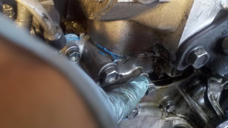

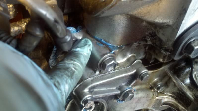

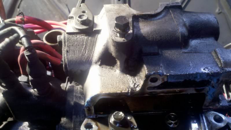

Yeah, right at the timing cover. I got 2 pictures to help show what I'm talking about. It's definitely seeping from the head, not the timing cover. I hope it's not the head gasket. I just replaced that when I got the truck about 2 years ago. If it is, it'll need to wait. I was looking into getting a new head and cam from engnbldr, but not install it until summer.
-edit-
Im only posting one pic because the second is just the same thing. Just slightly angled differently.

thats where mine was coming from. when i check the gasket i noticed i had been slightly damaged , a tiny tiny crease and i guess after so many heat cycles the oil made its way threw. and the head gasket is the only one that can leak front that point.

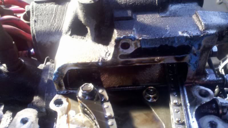

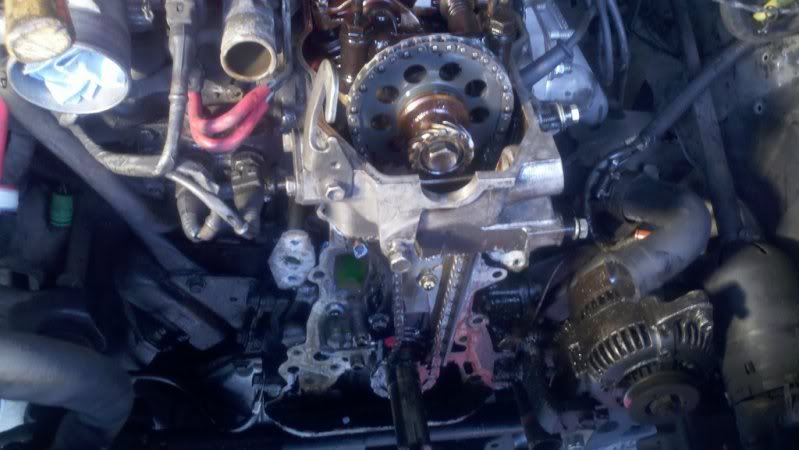

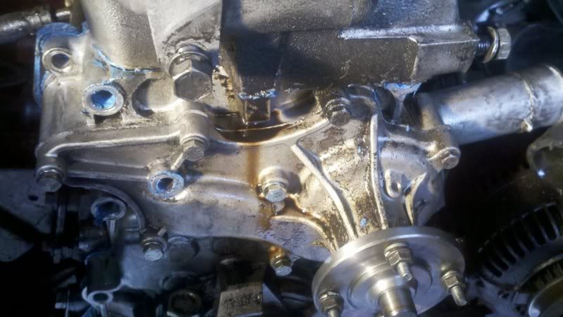

I tore down the front of the engine today - 4th time in 13 months - wahoo! What I determined was that it was NOT my "hidden bolt" under the distributor drive gear - there was a solid pool of oil there (see pic below). I'm 99% certain it's the void left by the part of the head gasket I had cut out with a razor blade last time I did the timing cover earlier this year.
I got a new timing cover gasket set this week, and plan to:
1) clean the cover and block, front of oil pan, bottom front of head
2) Use the gasket set and some RTV black to mate the timing cover to the block
3) Use FIPG to mate the bottom and top of the timing cover to the oil pan and head, respectively.
4) Let it dry over night, then fill it with oil again
Anyone see something wrong with my approach? If so please speak up ASAP as I plan to tackle this again tomorrow morning!
Some photos:

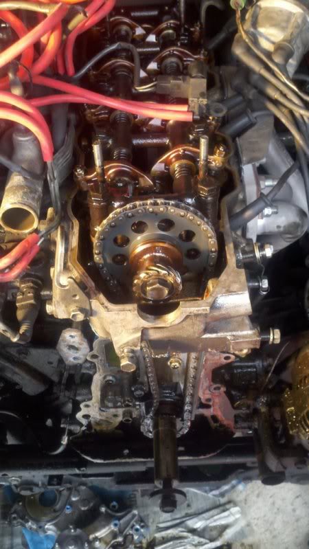

Halfway through tearing down:

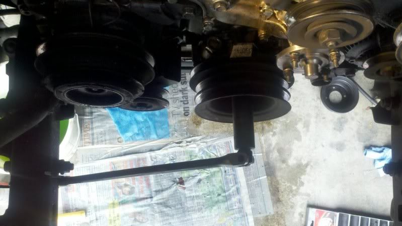

Good, old bump the starter with the breaker bar trick (thanks Santa!):

Pooling oil from the leak:
Where it would leak from immediately after turning the engine off:

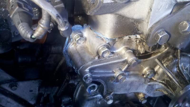

It's NOT leaking from the "hidden bolt":
Guts:

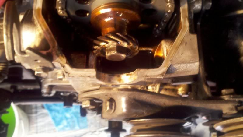

The offending leaky area that I plan to FIPG the hell out of (but not too much - don't want debris in the oil pan!):

In order for you to seal that area up, your going to need to drop the front of the oil pan down a little bit. Just enough so you can come up with the timing cover and not sliding it in horizontial. Putting it in any other way will just smear the FIPG all over. Don't seperate it too much or you will be dropping the oil pan to reseal that.
I agree that is the hardest part of doing a TC R&R, without removing the head, is the seal bewteen the bottom of the head and the timing cover.
Old Dec 28, 2010 | 07:25 PM
Philbert's Avatar
Joined: Dec 2009
Posts: 2,159
Likes: 8
From: Pleasanton, CA - SF Bay Area
Thanks Snobdds for the tip - that makes sense. I did drop the pan last time I did the timing cover. I used FIPG to seal it up and it has been great. How exactly would I drop part of the pan without breaking the seal? How many bolts would I need to take out? It may be best just to drop the whole damn thing again, to ensure this thing is sealed up for good....sigh.
