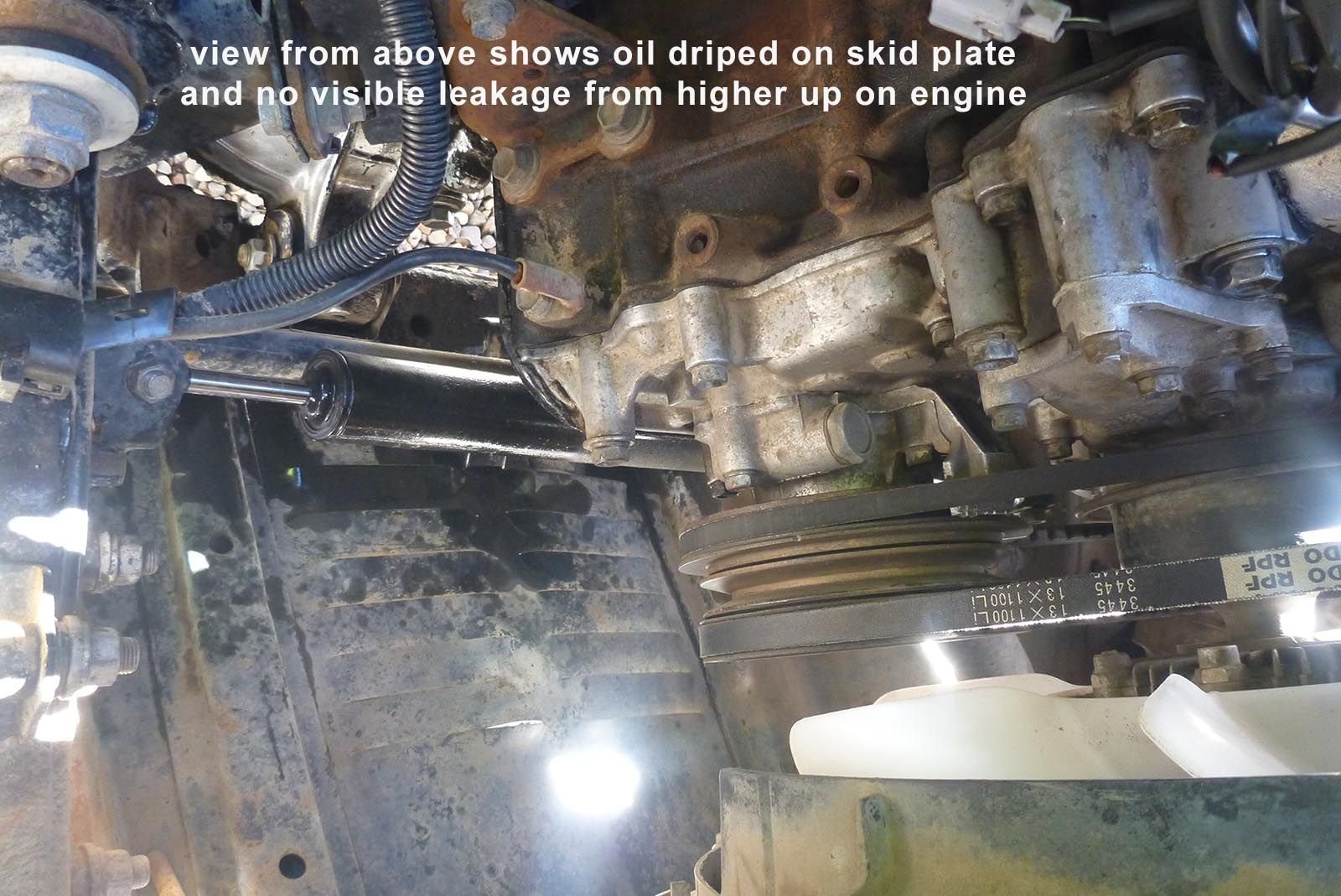

I recently developed an oil leak at the front of the engine. i started noticing drips coming of the skid plate. Initially I couldn't tell where it was leaking from, oil was kind of spread around the front and left side of the engine. I went to a car wash and sprayed the engine with engine de-grease and then power washed it. After driving a bit I could see the area it was coming from. It appear to be right where the fan and pulleys and etc attached to the front shaft coming out of the engine. It only leaks when the engine is running and it doesn't leak very much. Its been 1K miles since last oil change and I still read full on the dip stick. Still, I do not like it and wold like to get it fixed/make it stop.
I showed it to the mechanic I use and he said it was surprising I only had that small leak considering the age of the vehicle. He poured a bottle of something in the oil filler and told me to go home and let the truck idle for 2 hours (I accidentally let it idle for 4 hours) and then drive for some miles and see if it stopped. I drove about 300 miles. I feel it minimized the amount of leakage but that's a bit subjective. It for sure did not completely stop it. His next recommendation is, next oil change, put in high mileage oil and a quart of a Lucas stop leak additive.
He seemed to think it would not be insane to take apart everything necessary to replace whatever seal has worn out, but indicated it would be kind of pricy regardless.
I'm seeking advice and suggestions from you toyota experts. Does the high mileage oil and Lucas additive seem like a good next step? Is this a common leak point? What is involved in replacing the seal? Or any other comments etc. you may have. Thanks in advance for any help!

That leak is either from the front main seal, or , less likely, from the oil pump O-ring. Seals lose their elasticity over time.
The fix for either, or both, requires the fan to be removed, all the drive belts slacked and removed from the harmonic balancer sheave, and the harmonic balancer removed from the crankshaft.
This exposes the oil pump and the front main seal. The seal and O-ring will cost less than 25 dollars. Labor??? Well..... whatever they can hold you up for, if you can't, or won't do it yourself.
Pour-in additives are for suckers. Doesn't sound like your 'mechanic' wants to work on your truck.

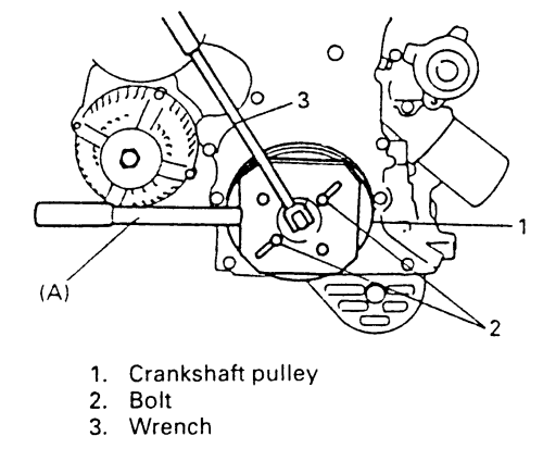

Here's the FSM for removing the crankshaft pulley ("harmonic balancer"): http://web.archive.org/web/201210231.../8timingch.pdf Note the torque is 116ft-lbs. Not too tough with a garden-variety breaker bar; the trick is keeping the crankshaft from turning as you apply the torque! Yeah, yeah, someone will advise laying the breaker bar against the frame and hitting the starter. It might work, but it won't do you any good. You still need a tool to put the bolt back in. Plenty of excellent shop-built tools described in these pages; I (of course) am partial to this one; https://www.yotatech.com/forums/f116...h-3vze-137934/

As has been mentioned, getting the harmonic balancer back ON is the hard part. 116 ft-lbs is a lot of torque, and keeping the crank from turning is rough. There ARE devices made just for this purpose, though. I can't remember where I got mine. I think McMaster-Carr catalog, but that was 30+ years ago. They look like this:
Honestly, I just use the "breaker bar on the frame and hit the starter" method for removal. It's a quick, easy way to do it. You just have to be certain, if you're the one holding the breaker bar, you trust the person on the key implicitly. You also want to be absolutely certain you put the breaker bar on the correct side of the farme, or it will swing around, hard and fast. Dangerous...
Toyota sells the holder wrench too: HERE.
