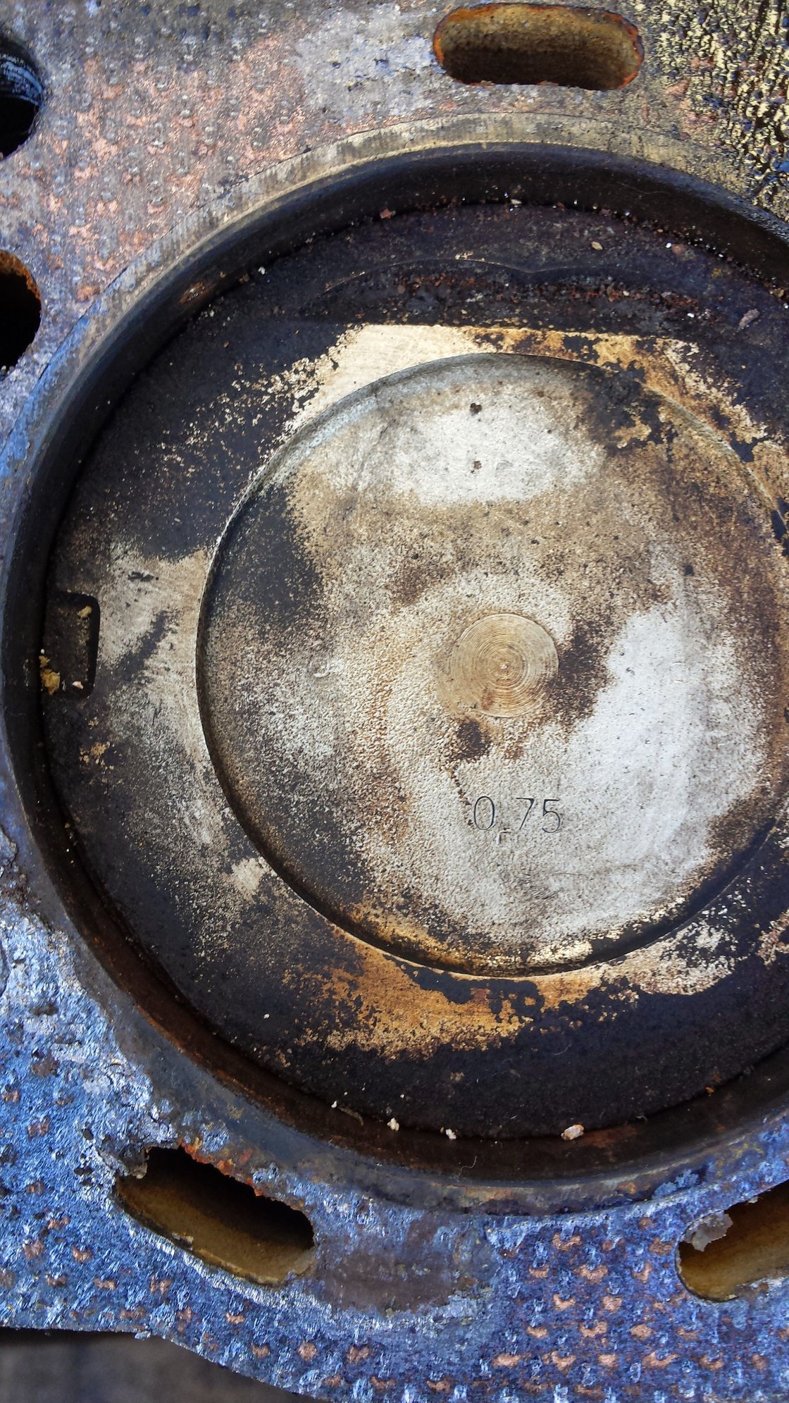

thank you very much for everybody's help, especially "greyheadedguy", I decided to rebuilt the engine. so I took the head off and found (0.75) on top of the piston. so my question what should be the ring size I order. maybe this is stupid question, this is my first time and don't want to have any problems. thanks

Wish I could help you, my pistons were stamped with 3s and other number like 2, and 4. You need to measure your cylinders. Harbor freight has a set of telescoping Gauges that you can run down into your cylinders to check the wear on them and the measure with a caliper. Not the best way in the world but will get the job done for about $30. I'm wondering if you have over sized pistons, oversized by .75? Get the tools to measure the cylinders and pistons to make sure you get the right size rings. It is the only way you will know for sure. Make sure you get a thing of assembly grease to put it together.

.75 is almost certainly 3/4mm oversize

.75 is 0.75mm oversize, which is about 0.30" over stock bore size. Before putting rings in it would be a good idea to measure the cylinder at the top, but under the ridge. Otherwise you may have the same problem and will have to bore/new piston or find another block. Or check the ring end gap with a new set of rings, if it's over 0.50mm it's time for bore/pistons.
