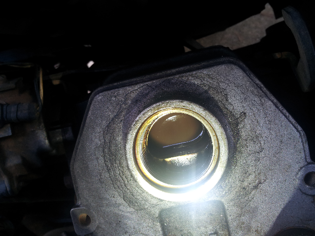

I might be a bit paranoid but to me that oil doesnt look right. Though it is about 4k old and the reflection of the light might have something to do with it. In the second photo u can see i am leaking what appears to be oil. But what is it leaking from? I dont recognize that part. Any thoughts?

that doesnt look right..check your dipstick!

Just pulled over and checked the dip stick and it looks 100% normal.

has it overheated? did you oil cap have any odd colored spots on it? that oil has water in it no doubt. it will be hard to tell if there is coolant in the oil by checking the dipstick. if anything you'll see a white spot in the bottom. change the oil and the coolant. if there is oil in the coolant its most likely a blown hg for sure.

easiest thing to do is pop the hood and start squeezing any hose that has coolant running through it. if you see a leak, even the slightest, that could be the problem. if you see nothing start it up and let it idle and do the same thing. i have spotted a few 'pissers' in the short amount of time ive owned older vehicles.
edit
after looking at the 2nd picture, it looks like your water pump gasket is leaking. the steel bracket below it has surface rust on it under the wet area of the pump. oil wouldnt make it rust.
Never over heated before. I really think the way the light was hitting the oil made it look milky in the photo. I just drove 500 miles today and had no issues. Half way through I checked the dipstick and removed the oil cap to look. Without the led flashlight the oil looked just fine. Plus my fluid level in my radiator reservoir did not go down at all. After 500 miles I would suspect it to go down a hair if it was a blow HG.
edit
Interesting. Well I do know oil is coming out of there somewhere. I can see it building up around the oil pan gasket on that side do the motor. Still have not seen my truck mark her territory yet. Not one drop.

Forgot to mention this, but honestly not sure if this matters. I run a approx. mix of 80% amsoil full synthetic and 20% lucas oil stabilizer. Lucas has a clear greenish look to it. Mix the two and who knows what it would look like. Just throwing that out there.

If water is in the oil, eventually, you'll see condensation inside your oil filler cap. You may see oil in the radiator, but the water on the filler cap is what I look for. My coolant slowly disappears as well but I know what it is; the lower radiator hose has a sloooooow seepage from the area where the hose clamp is. No matter how much I tighten it, it has that very slow leak. It's hard to see, rarely a drip can be seen and road dirt and grime hide most of the seepage. Any of the cooling system hoses, especially those that are hard to see and harder to reach, may have this kind of slow leak. Bad radiator cap is a good thing to check, cheap to fix, not a bad idea to replace it every so often.
Oil leak, but not on the ground? Take a good close look at the valve cover gasket. Oil near the top of the engine, where it's hottest, may burn off, but what doesn't burn off collects on that flange the oil pan bolts into. Or, it could be the oil pan gasket itself and who wants to change that, unless it's leaking really, really bad.

I just checked the oil again and it looks good and there was no condensation under the cap at all. Thanks for pointing that out.
With regards to the leak: I originally thought it was the valve cover as well, but I can't see any evidence at all. It just randomly appears about a half inch above the part in the pic.
