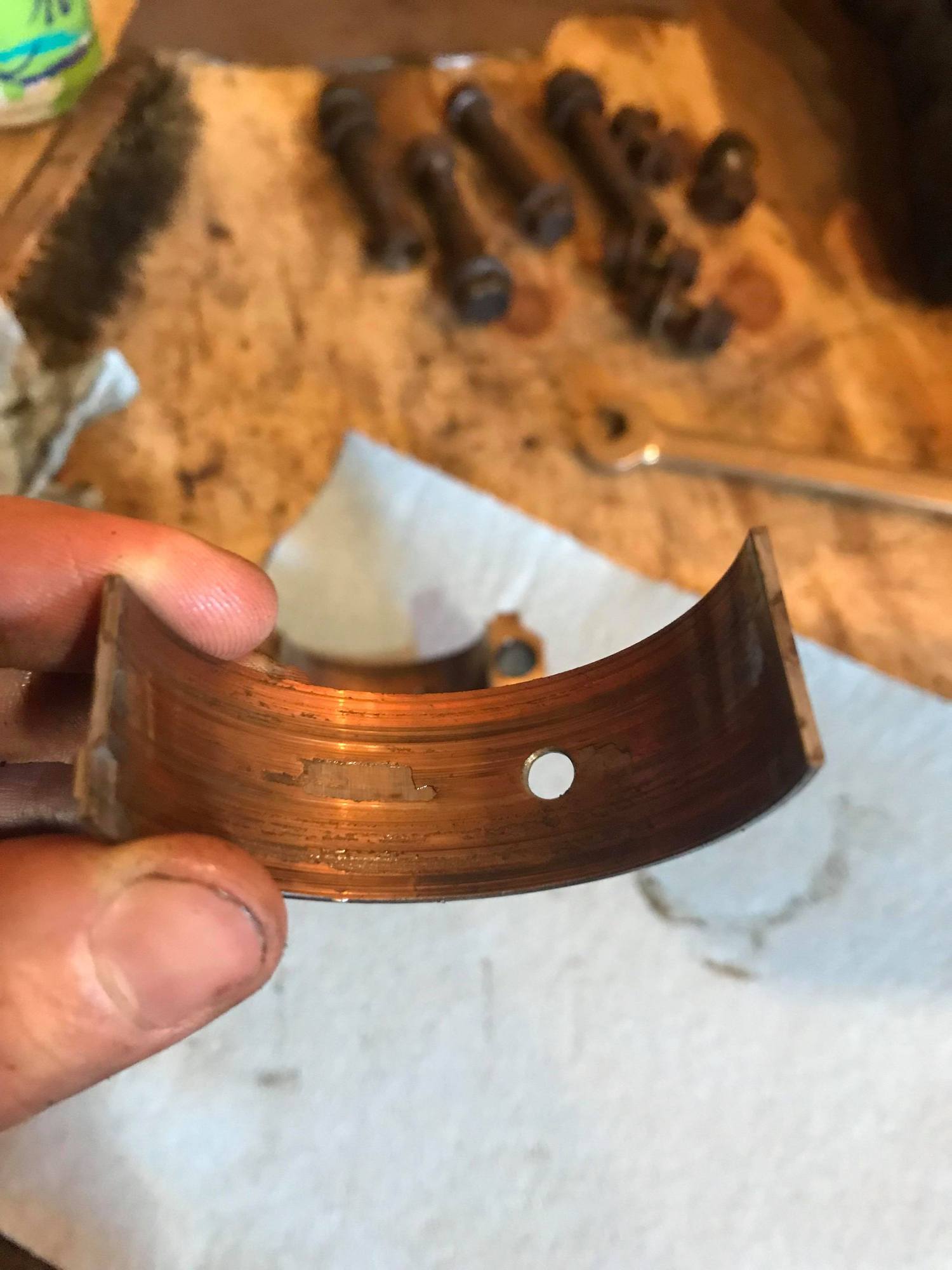

well, I had some time to pull the oil pan and its not looking good. All of the bearings have some side to side play but only cyl #2 had up and down play. I removed the cylinder # 2 rod cap to find
Old Dec 17, 2018 | 10:57 AM
  #56
Mason Edmison's Avatar
Joined: Jun 2018
Posts: 90
From: Milwaukee, WI
crank bearing
rod bearing
didn't even bother pulling any of the others. The crank shaft surface is not terrible but there are some slight grooves in it. I really don't know what to do here. If I should try to pull it and rebuild it. or try to find one to drop in it.
I bought the truck for 500 dollars and have probably put 500 more into it so the idea of sinking more money into it kind of makes me sick.
Details Monsieur or Madame..
Side to side, intake to exhaust or fore aft. (Not so much relevant, but curious what you tried)..
Up and down, presumably the connecting rod /piston direction?
You wouldn't notice any movement on a proper clearance bearing since it has a spec of a few thousandths.
Really dig that first bearing picture, saddening but, it shows the composite construction method very well.
Good news is you caught it before it spun in the cap and destroyed the block. Congratulations you saved a classic Toyota.
A machine shop might be able to turn that crankshaft down and it fit an available bearing size, but until they try you won't know for certain if it needs resurfaced. They will also try to talk you out of doing it.
You are only 1k in to it and already balking, this is a bad sign.. But we urge you to stick with it. Buy another "dime a dozen" beater, do a little bit of work and sell it when the Yoda is fixed for a small profit.. Win win.
Terry has used several ~1k$ engines from a place that escapes my mind currently.
haha I was still very worked up on that last post. Since calming down... I am going to pull it and rebuild it. I talked to my machine shop guy and he thinks for deck tanking the block, honing the cylinders, decking it and *hopefully* turning the crank I'd be looking at about 200 dollars. I see that several places (lce) sell several different sizes of oversized bearings so that leaves me hopeful.
ah when I meant side to side, I think I meant what you called fore and aft or front to back of engine. Definite noticeable up and down (connecting rod and piston direction) on cylinder 2.
Luckily, I have my trusty honda accord to drive in the meantime (it has very rusted fuel lines so fingers crossed, gd wisconsin living).
Anyways, Im hoping to get the engine ready to pull this week so I can hopefully either A) rent a cherry picker or B) buy one from h freight.
