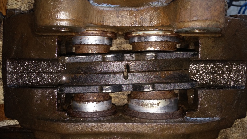

While replacing the bearing Im also rebuilding the breaks...
would you guys scrap these pistons or use them for a rebuild?
looks like some rust or pitting on the pistons? i'd do a teardown and see if the bore is smooth.
you might want to price some quality rebuilt calipers.
Old May 9, 2016 | 04:50 PM
Drahog's Avatar
Joined: Feb 2016
Posts: 53
the pistons have pitting the bore is smooth.
