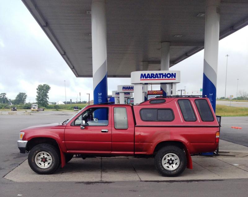

I talked to the same "tech" today (Who I found out through certain channels is the president of the company) and he told me based on the photos I sent to him, that they believe that my front suspension has a lift on it and that is causing more weight to be carried by the rear springs causing them to sag. ya, that's not the way things work. After telling him that a simple ride height measurement verified that the front was set to the factory specification (measures 13-3/4"), and having him rabble on that some other techs claim that I have my torsion bars cranked, I lost all faith his ability to handle this situation.
This is the picture that I sen't him that apparently show my lifted front suspension. This picture was taken before I replaced the rear leaf springs.

Although he did say the manufacture is testing multiple examples of the specific spring in question to verify spring rates are correct, I've decided to give them until Friday to come up with a suitable solution to my problem or I'm going to ask for a full refund. Hindsight being 20-20, should have just spent the extra $150 and got some OME dakar springs. lesson learned

just curious how much other stuff do you have in the back of the truck plus the weight of the cap??

In the above picture, the only thing in the bed are some camping supplies that weigh <100 lbs. if I was to estimate the weight of the cap, I would say between 150-175. I'm not the strongest person in the world, but I and another person were able to take it from a waist height to chin height without too much fuss.
The thing is the truck doesn't have a rear bumper, spare tire, or the spare tire holder and winch. I estimate the weight those items combined would be very close to the weigh of the cap.
I have taken the cap off just to make sure that it wasn't the cause of the sag. With it off the rear end still sits on the overloades without any weight in the bed. I sent the company pictures with the cap off showing that the springs sagging to the overloads, but they still won't give me a straight answer.

definitely sounds odd. i've never heard of different leaf springs for our trucks either - except for maybe the 2wd pickups 1-ton version. i'd think a leaf spring shop SHOULD know if it is true, so maybe it is.
you don't want to mention the brand of leafs you bought? just curious, since i never found stock height leafs when I was looking for my truck - they were all including some sort of lift unless you spend big $ and went with custom leafs.
I ended up with OME Dakar mediums on my truck and am very happy - many times I have loaded the bed with ~1500# and the rear only drops slightly past level (was slightly raked past level, so drops maybe 2"). before new leafs i'd be riding the bump stops with a load and my truck looked almost as saggy as yours in the pic without any load.
